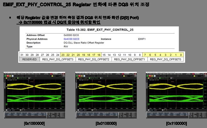

  • Hello Dobrin,
    Thanks for the feedback.
    Customer checked "EMIF_EXT_PHY_CONTROL_25" register changes the skew between the write DQS and the write DQ signals as below.
    Measuring data0 and DQS0, it shows that the skew is changing as "DQ_OFFSET"
    Customer asked how they find the proper DQ offset at customer board.
    It is impossible to measure all the data lane (DQ and DQS)  by changing DQ_OFFSET.

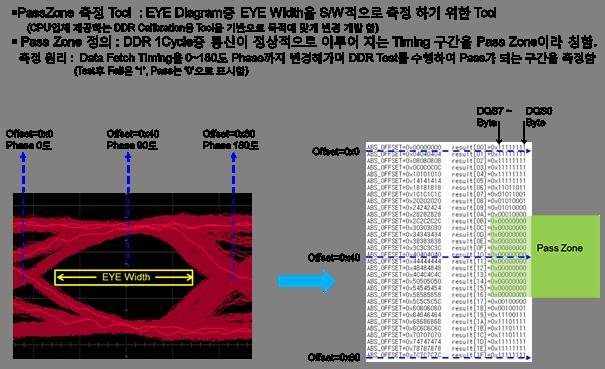

    Competitor provides the calibration tool to find the profer DQ offset as below.
    Do we have similar tool as below?
    (p.s.  TRM says only that 0x40 is recommended with 90 degree shift, but the measurment shows that it is not the centor (90 degree).)

  • Hi Lloyd,
    You measure at the SDRAM side, right? Value of 0x40 should be for 90 degree shift at SoC side and if the trace length matching requirements for DQ and DQS are met, 90 degree shift should be observed at SDRAM side but as shown on your diagram above it is approximately 45 degree shift. So, I assume this might be due to trace length mismatch between DQ and DQS.
    Another strange thing is that your first diagram from the first post looks exactly like the first one above where 0x40 is loaded to DQ_OFFSET. Have you checked the value of DQ_OFFSET before writing another values? As TI recommends 0x40 I assume that the default value for your system has also been 0x40 which would explain why both diagrams are matching.

  • Hi Dobrin,
    The First diagram from the first post is taken with the default value, which is 0x40.
    That is the reason the diagram is the same as the first diagram from second post (0x40), as you're assuming.
    Please let me know TI can provide some kind of calibration tool for proper DQS offset.
    Thanks a lot.
    Lloyd
