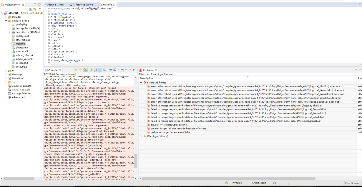

Error compiling the EtherCAT example in ISDK 02.01.02.02
Other Parts Discussed in Thread: SYSBIOS
 , I utilized the ti resources explorer and follow the steps to import the example but i dont know what to do then due to this problem.

  • Hi I just tried to build the same project and it builds OK.
    From user guide we have:
    Software
    Code Composer Studio version CCS 6.1.2.00015
    Industrial SDK version 2.1.2
    SYS/BIOS 6.45.01.29 Real Time Operating System
    XDC Tool 3.32.00.06
    NDK 2.24.3.35
    Compiler GNU v4.8.4 (Linaro)
    http://processors.wiki.ti.com/index.php/SYSBIOS_Industrial_SDK_02.01.02_User_Guide
    Please check your tools versions are correct, also check environmental variable IA_SDK_HOME points to the correct ISDK path (for example: C:\TI\sysbios_ind_sdk_02.01.02.02\sdk\), clean build and rebuild
    thank you,
    Paula
