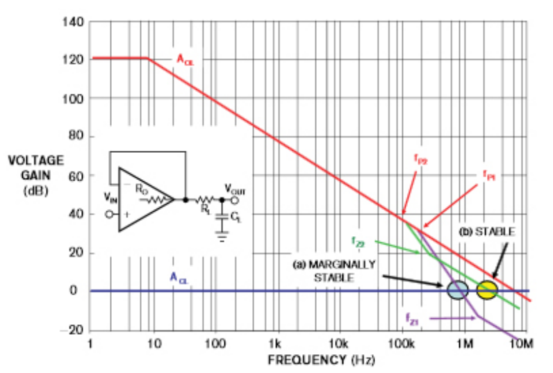

    In addition to Biser's answer and important Caution, take in mind following specifics about  the applied voltage follower circuit.
    The problem with these passive filters is that frequency selectivity is achieved by dissipated unwanted frequencies and it is impossible for any frequency components in the input signal to be amplified by this type of filter.
    A capacitor and a resistor that hang on the output of an amplifier change the amplifier's open-loop-gain curve. The combination of the load capacitor, CL - the load resistor, RL - and the amplifier's open-loop resistance, RO (out) , introduces a pole to the open-loop-gain curve, and CL and RL then introduce a zero to the open-loop-gain curve, see the figure below. Creating this pole and zero does not disrupt the amplifier's stability as long as they cancel each other out before the open-loop-gain curve crosses the closed-loop-gain curve. If the open-loop-gain and closed-loop-gain curves cross with a 40-dB/decade closure rate, the amplifier circuit will be marginally unstable or, worse yet, will oscillate.
    You can find the pole and zero locations in this circuit in the following equations:

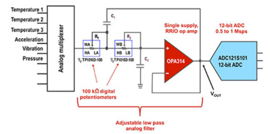

    I would recommend your customer to use following simple low pass filter for reducing ADC aliasing errors:
