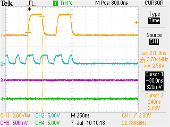

    suggested calibration said:
    SET_TP(TX_OFDM_TP);  // Set test point High
    CLR_TP(TX_OFDM_TP);  // Clear test point
    Here is a picture from the scope:
    Topmost yellow line is test point.

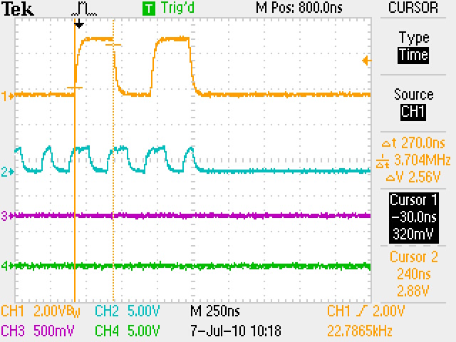

    For next test
    x = EDMA_RGET(ESRL); // dummy config bus read
    EDMA_setChannel(dma->hdl_tx_ch1_r); // Trigger event
    picture is
    Here again topmost yellow line is test point. Second blue line is CE signal of FPGA. Several CE strobes before test point high first time are FPGA interrupt register read and clear. But now seems I know the reason for delay. I think, that immediately after EDMA_setChannel EDMA controller starts the transfer. So our attempt to CLR_TP(TX_OFDM_TP); will compete with this transfer.

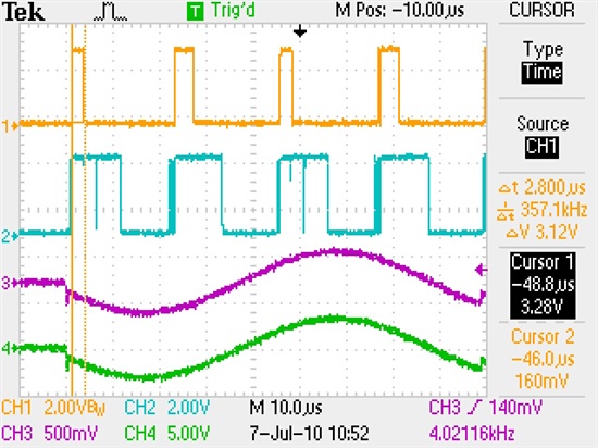

    I have also noticed, that set/clear test point sequence happens faster during read transfer. On the following picture odd strobes correspond to read setup and even strobes are for write setup. Former ones are of 2.8 us and latter - 4.4 us.
    So I guess, my approach to benchmark using FPGA test point was wrong. Could you please comment on this? Could you please suggest some better test to verify timing and performance?
    What does this mean, "read transfer"? I think I understand that the write transfer means writing to ESR to start the DMA transfer and that you believe the DMA transfer to the FPGA is holding off the length of the test point pulse. Is the read transfer one in which you are reading from the FPGA and the write transfer is when you write to the FPGA?
    Looking at the blue line, I would have expected it to be low during the DMA transfers to the FPGA. Is there a different CE used for these DMA transfers? Is this the same CE that is used for the TP macros to read/modify/write the TP register in the FPGA?
    If you can use some other pin on the DSP as a GPIO, like an unused timer pin or serial port pin, that would avoid any conflict with the EMIF going to the FPGA. Or if you have a timer that could be read before and after the function call, instead of the SET_TP/CLR_TP macros, you could get a measurement of the time it takes to make the function call and return.
