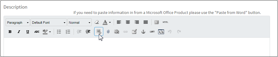

    Paste for picture does not seem to work with your blog.
    I thought it was clear though, it doesn't display past about half of the screen. As for the 7 inch I do not seem to have the issue with the HDMI display connected. I will have to double check later if that is an issue that was removed with the latest revision or that it is only present when I only have the LCD on and no HDMI.
    You have to insert an image like this:

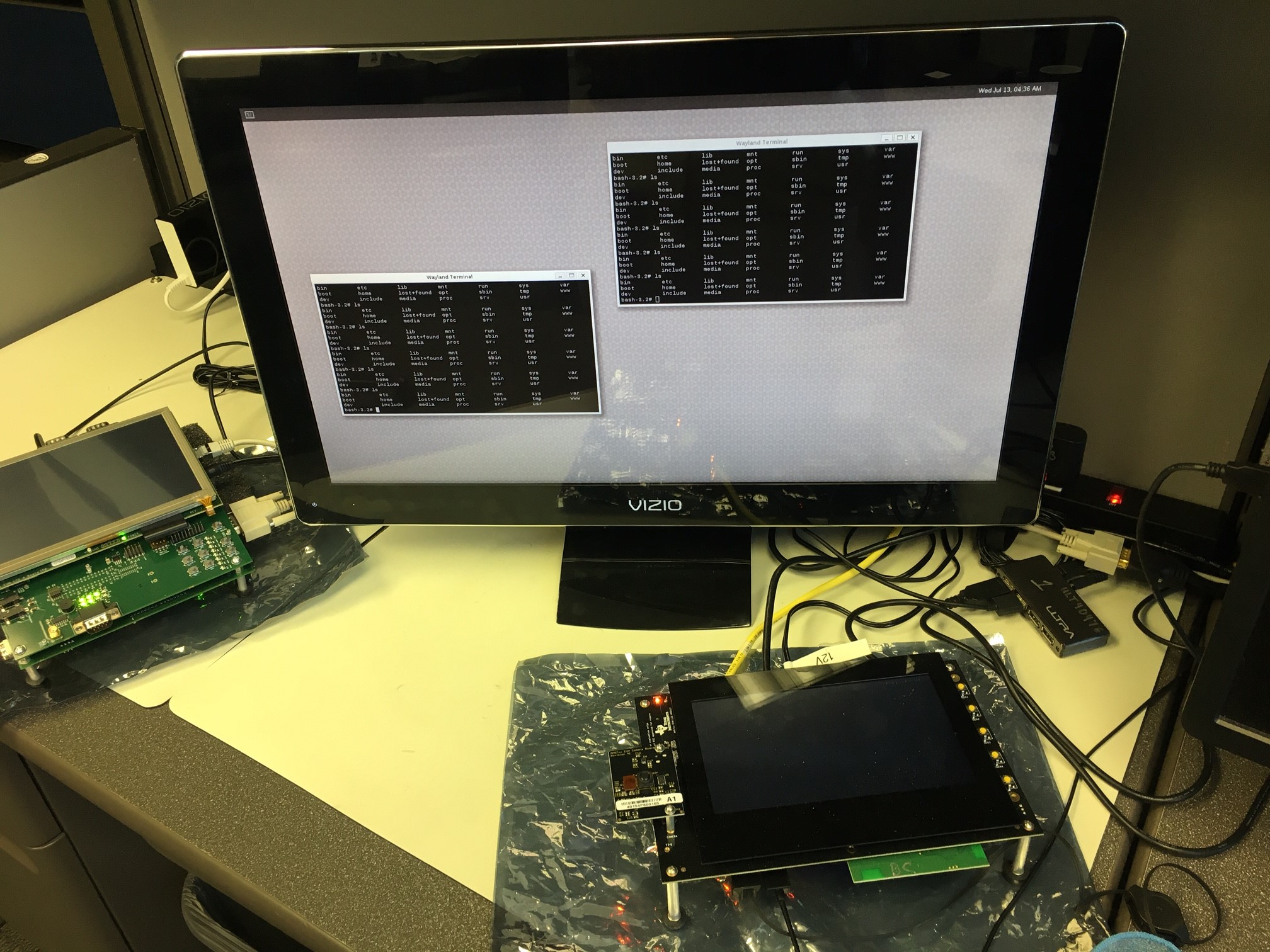

  • I have my board connected to a Vizio 1080p television.  I have a keyboard and mouse connected to my AM57xx EVM.    I exit the Matrix GUI, and open a command prompt on the Vizio.  I can open multiple terminals, ls many directories, move the consoles around the screen, etc.  Everything is working fine.
    Here's a picture:
  • You are not testing the same way, you still have the weston desktop running in the background. To see the problem do ctrl alt F1, log on root and do a few directory listing and you will see that it will not go past half of the screen.
