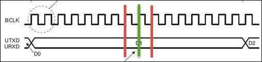

  • Hi Vasanth, could you confirm a few things based on your previous response?
    • Is the voting mechanism a simple majority vote, i.e. 2 or more logic level low = low, and 2 or more logic level high = high?
    • Is the beginning of the start bit considered to be the first sample clock that the received data is logic level low?
    • I have tried to capture your description in your previous post in a drawing, could you check to see that I have interpreted your answer correctly? I want to make sure I have specified the correct number of sample clocks between events. I am surprised that bit 7 is the determining bit since it is not in the center, perhaps I have drawn it wrong?
    the dotted line represents when the first logic low is sampled, the red lines are the voting sample points, and the green line the point at which the bit value is determined.
    Here is my answers for your Questions.
               - Yes its a mechanism of simple majority voting.
               - Yes
                - Yes,  as mentioned earlier the voting is decided on the eighth clock edge which is in the center. The your drawing looks correct with respect to previous consecutive samples being considered.
