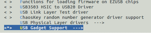

How to build the g_printer gadget in the kernel?
My board is am335x-evm, SDK is ti-processor-sdk-linux-am335x-evm-02.00.02.11.
I used well g_printer (usb device mode) driver.
Method of g_printer that I have used is the module type(configfs.ko,libcomposite.ko,g_printer.ko).
I want to built in the usb device (configfs, libcomposite ,g_printer)  to the kernel.
I checked these wiki pages:
http://processors.wiki.ti.com/index.php/UsbgeneralpageLinuxCore
http://processors.wiki.ti.com/index.php/Linux_Core_MUSB_User's_Guide
but I can't find any method for built in the usb device to the kernel.

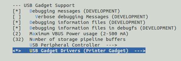

I changed kernel menuconfig as below.
I don't know next step.
Do I have to use "insmod" after kernel menuconfig setting?
How can I do it?
thank you for supporting me all the time

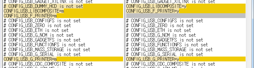

    1. The menuconfig settings you've done are correct. After you do the modifications in menuconfig, you need to save them & exit. Then check the .config file for:
    CONFIG_USB_LIBCOMPOSITE=y
    CONFIG_USB_G_PRINTER=y
    Rebuild the kernel & flash it on your board.

  • I tried to your advice
    After I did the modifications in menuconfig, save menuconfig and exit.
    I checked the .config file
    and rebuild the kernel and flash it on my board.
    but g_printer doesn't work.

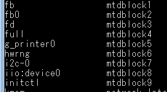

  • HI, Yordan Kovachev
    1. Can you run lsmod and share the output? Do you see g_printer anywhere?
       1) source position
        linux-4.1.18+gitAUTOINC+bbe8cfc1da-gbbe8cfc/fs/configfs/configfs.ko
        linux-4.1.18+gitAUTOINC+bbe8cfc1da-gbbe8cfc/drivers/usb/gadget/libcomposite.ko
        linux-4.1.18+gitAUTOINC+bbe8cfc1da-gbbe8cfc/drivers/usb/gadget/legacy/g_printer.ko
       2) run lsmod output
        3) g_printer position (/dev/)
    2. Is it possible to use the equivalent function driver: usb_f_printer?
       I found just usb_f_printer.o file in /drivers/usb/gadget/function
       how to use the usb_f_printer?
