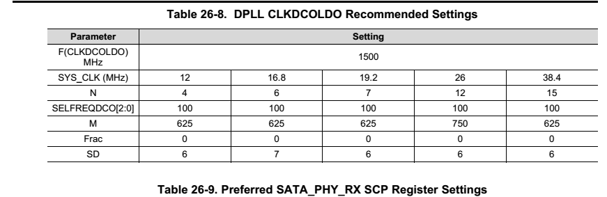

Vayu/Jacinto6/DRA74x: Are there any special considerations for tuning of the SATA interface and PHY's?
I have a customer using a SATA DVD player with a Vayu/Jacinto6 (DRA74x) device. They have the interface working with their 19.2MHz oscillator using the standard SATA clock values from the TRM.
The question came up whether there were any special SATA PHY tuning requirements and if so what is the proper tuning process for the SATA interface on customer specific hardware.
