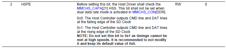

  • Shiou Mei,
    No, MMCHS_HCTL[2].HSPE is as below. it does NOT control default/high speed mode selection. it controls which edge is used to outputs CMD line and DAT lines.
    In fact, From DM, high speed mode is used falling edge to output CMD/DAT line same as default mode.
    So, both default mode and High Speed mode are used same MMCHS_HCTL[2].HSPE setting.
    In addition, the note said
    NOTE: Do not set this bit to 0x1 as timings cannot be met at high speeds. It is recommended to not modify it and keep its default value of 0x0.
    So, this bit is NOT contolled default mode/High speed mode.
    I could not find any other bit which select default mode/High speed mode.
    BTW, I would like to confirm that the word "high speeds" in the NOTE in the HSPE bit description is pointed "high speed mode" or "higher speed mode like SDR50,SDR108 ? or both ?
    Yasuhiro Mitsui

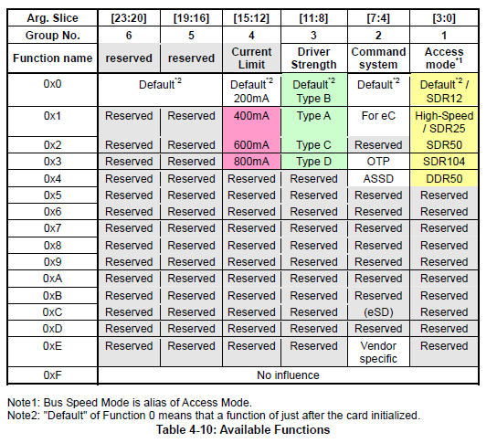

    The settings I provided were to enable the HW for different speed mode configurations. HSPE is in general used for SDR modes, but should also be applicable to high speed as well. Let me check to see if we are limiting its use based on AC char results.
    To communicate the actual frequency change, SW drivers should send CMD6 (switch command) for Function Group 1 modification. The same command can be used to update drive strength, current limit, etc. Table 4-11 "Available Functions" (snapshot attached) in the SD Simplified Spec provides details on how this is used. User should send CMD6 with Mode 1 according to Section 4.3.10 "Switch Function Command".
    SD Simplified Spec can be downloaded here: members.sdcard.org/.../part1_410.pdf
    Shiou Mei

    Could you tell me the programing sequence that MMC host controllers inside the Jacinto6 switch Default mode to High Speed mode after sending CMD6 ?
    The CMD6 is used that host requests the desired speed mode to card.
    Once Card is accept it, host should be change its configuration.
    Drive strength can be changed MMCHS_AC12[21:20].DS_SEL
    But no speed mode configuration bit is exist.
    Yes, we have UHS Mode Select at MMCHS_AC12[18:16].UHSMS. but it can not select HS mode.

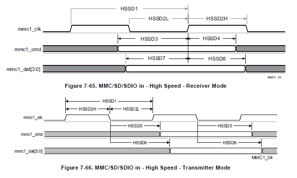

    Jacinto6 has definitely difference Setup/Hold/Delay timing for default mode and HS mode.
    In my understanding, these parameter is NOT depend on Clock Frequency.
    So, most probably, MMC host controllers has some mechanism which switch the mode internally.
    But we dont have any configuration bit like 0:Default Mode/1: HS mode.
    How MMC host controller change it ?

  • Mitsui-san,
    That's correct.  MMCHS_HCTL [2] HSPE mode was initially used to change timings from Default Speed to High Speed mode, but given the internal timing limitation indicated by the note in TRM, this mode should not be used.  Hence, upon CMD6 mode 1 switching command sent to card, and the internal clock frequency changed to 48 MHz, the MMCHS host controller will be compatible to operate in the desired High Speed clock frequency.
    Thanks & Regards,
    Shiou Mei
  • After offline discussion.
    Conclusion is as below.
    - The MMCHS host controller uses the same state for DS and HS mode. Only the clock frequency changes between DS and HS mode.
            If someone understand set MMCHS_HCTL.HSPE = 1 initiate to transit internal state from DS mode to HS mode, it is misunderstand.
    - Jacinto 6 supports HS mode. Generic sequence to enable such mode is as follows:
    1. Check card capability to use HS mode
    2. Send CMD6 with Mode 1 to card to switch card operation into HS mode
    3. Configure Host MMC bus clock frequency
    4. Meet AC timing by setting MMC virtual/manual mode delay timing per DM Table 7-2 Modes Summar
    Again, no internal state change is nessesary. Internal state is same for DS and HS mode.
    - The timing tables in the datasheet represent the timings required in each mode (DS and HS) to be compatible with the DS and HS mode JEDEC memory timing specs.
    Yasuhiro Mitsui
