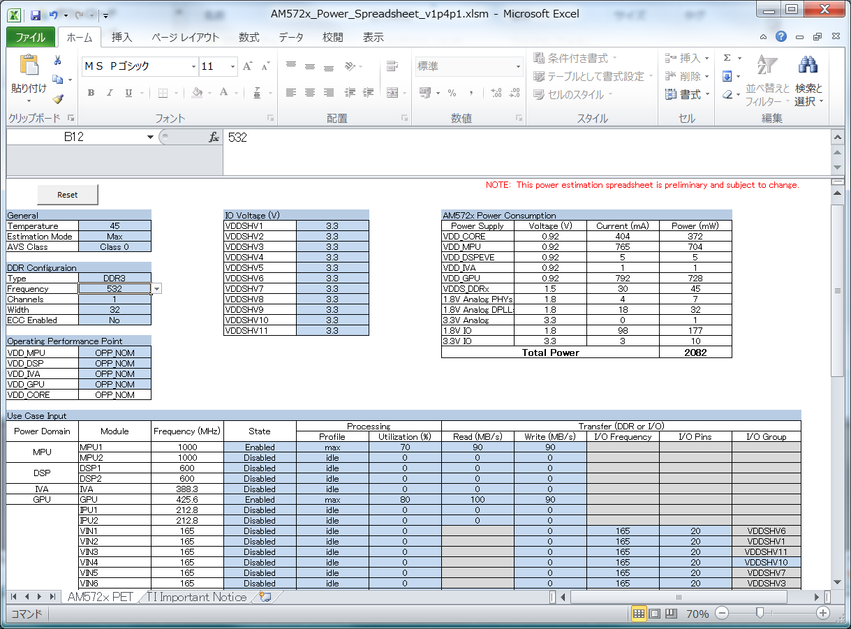

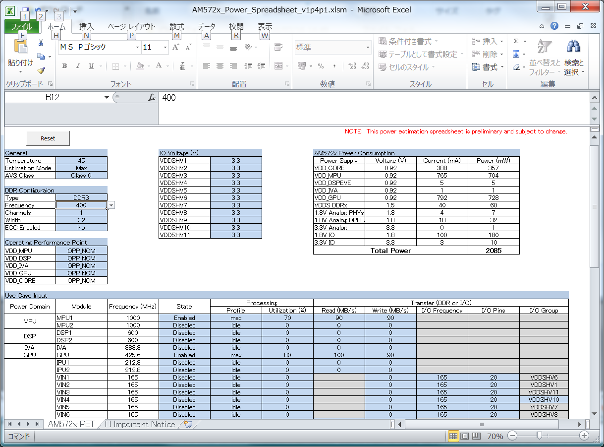

I have one question regarding AM5728's power consumption.
I calcurated the power consumption of AM5728 with one use case. Please see the below two pictures.
As you see from the pictures, I changed DDR3 frequency from 532 MHz to 400 MHz. Please see the total power's cell.
DDR3 532MHz working : 2082 mW (VDDS_DDRx : 30mA )
DDR3 400 MHz working : 2085 mW (VDDS : DDRx : 40mA)
I was surprised this result. Because I thought DDR3 lower frequency is lower current. But the result was that the current of DDR3 400MHz is bigger than the current of DDR3 532MHz.
I don't know why this result happened. What is the cause of this result?
Please let me know.
