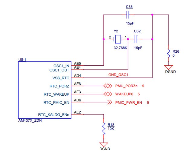

AM437x does not wake up from DeepSleep0 by TPS65218 button
Other Parts Discussed in Thread: TPS65218
After I enter "echo mem > /sys/power/state" in kernel, the kernel can goto low power mode correctlly.
But I can't wake up it when I push the PB button for TPS65218.(I can only wake up the kernel through UART interrupt).
Does there any registers need to be configured for the PB button for wake up?
Thanks.
The following is my board schematic:
    See section 6.4.5 on the AM437x TRM Rev. E. The PMIC power button is not a valid wakeup source from DeepSleep0. It can only be used for wake up from RTC-only mode
  • Thanks for you quickly reply!
    Well, this is a bad news for me.
    I want to use PB button and some other irqs to wake up the kernel.
    1. I have noticed that when I push the PB button, the PMIC will generate a PMIC_INT which is connected to AM437X_NMI, can this intterupt be used as a wakeup source?
    2. For other irqs(a gpio interrupt for example), can I set the irq as a wakeup source? How should I do?

  • The wakeup sources are listed in section 6.4.5 on the AM437x TRM Rev. E. You should connect to a GPIO0 pin to wake up the device.
  • I see...
    So only GPIO0 can be the wakeup source when the chip enter DeepSleep0, other GPIO can' be. Is it right?
    How about DeepSleep1(standby)?
    Table 6-13 in the TRM says standby can be "Wakeup from any GPIO", it means not only GPIO0 but all GPIOs can be a wakeup source, am I right?
    Thanks!
  • Yes, this is correct.

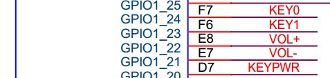

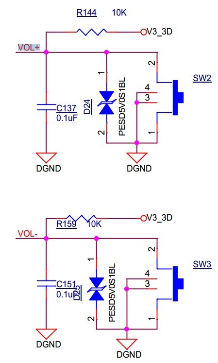

  • Hi Biser Gatchev-XID,
    I have done some tests for gpio wake up, unfortunately it can't work on my board.
    My kernel is 3.14.
    My dts:
                   vol-down-key {
    gpios = <&gpio1 21 GPIO_ACTIVE_LOW>;
    linux,code = <114>;
    label = "volume down";
    debounce-interval = <1>;
    gpio-key,wakeup;
    vol-up-key {
    gpios = <&gpio1 22 GPIO_ACTIVE_LOW>;
    linux,code = <115>;
    label = "volume up";
    gpio-key,wakeup;
    My test:
    root@am437x-evm:~# echo standby > /sys/power/state
    [ 3440.098461] PM: Syncing filesystems ... done.
    [ 3440.122111] Freezing user space processes ... (elapsed 0.001 seconds) done.
    [ 3440.130849] Freezing remaining freezable tasks ... (elapsed 0.001 seconds) done.
    [ 3440.140089] Suspending console(s) (use no_console_suspend to debug)
    And then I push either the vol-down-key or the vol-up-key, they all can't wakeup the kernel, still only UART can wake up...
    [ 3440.153792] PM: suspend of devices complete after 6.067 msecs
    [ 3440.154566] PM: late suspend of devices complete after 0.751 msecs
    [ 3440.156089] PM: noirq suspend of devices complete after 1.498 msecs
    [ 3440.156320] PM: Successfully put all powerdomains to target state
    [ 3440.156320] PM: Wakeup source UART
    [ 3440.157915] PM: noirq resume of devices complete after 1.527 msecs
    [ 3441.967731] [sched_delayed] sched: RT throttling activated
    [ 3441.968725] PM: early resume of devices complete after 0.789 msecs
    The schematic:
    I have no idea why I can't wake up.
    Does this is a correct way?
    Thanks!

    I have checked my dts, and it seems no problem...
    I have checked the following logs:
    root@am437x-evm:~# cat /sys/kernel/debug/wakeup_sources
    name            active_count    event_count     wakeup_count    expire_count    active_since    total_time      max_time        last_change     prevent_suspend_time
    gpio-keys.7     2               2               0               0               0               0               0               64715           0
    I pushed the button to try to wakeup the system, it failed, then I use UART to wakeup.
    From the above logs, the GPIO seems have some effects on the system, since the count was changed.
    I attached my dts, could you please do me a favor to have a check with the file?
    I am using the VOL+/VOL- button to wake.
    Thank you!

    I have follow the am335x-evm.dts, but still can't wake up...
    I have noticed that the GPIO used in am335x-evm.dts were GPIO0, but I am using the GPIO1.
    Does there any different when wake up from standby mode?

  • User4552302,
    I see that wakeup is not enabled in the 0x44e10854/0x44e10858 registers.
    CTRL_CONF_GPMC_A5[29] WUEN = 0
    CTRL_CONF_GPMC_A6[29] WUEN = 0
    Wakeup— I/O PAD can be individually enabled for wakeup using PADCONFx.WUEN register bit. The wakeup controls and events (as well as enable and disable controls) travels through asynchronously through the chain during DeepSleep. The global wakeup chain is enabled/controlled by the PRCM. This is global control is achieved by qualifying each of the I/O PAD wakeup enables with global wakeup daisy chain control coming from PRCM.
    Can you try the below modification in your DTS:
    gpio_keys_pins_default: gpio_keys_pins_default {
    pinctrl-single,pins = <
    0x54 ( WAKEUP_ENABLE | PIN_INPUT | MUX_MODE7 ) /* (E7) gpmc_a5.gpio1[21] VOL- */
    0x58 ( WAKEUP_ENABLE | PIN_INPUT | MUX_MODE7 ) /* (E8) gpmc_a6.gpio1[22] VOL+ */
    See the below file for more info:
    linux-3.14.26/include/dt-bindings/pinctrl/am43xx.h
    Can you also provide me the value of PRCM_PRM_IO_PMCTRL register?
    Pavel

  • user4552302,
    I see you are using internal pull in the pinmux settings. As you are using external pull-up, you do not need internal. Can you try with removing the internal pull (up/down) feature?
    Can you also provide me the value of PRCM_CM_PER_GPIO1_CLKCTRL register (before suspend and after wake-up from uart)?
    Can you provide me GPIO1 register dump before suspend and after wake-up from uart (with button switched between suspend and wake-up)? See AM437x TRM, section 28.3.3 Interrupt and Wake-up Features, for what you should have in these registers.
    Also, when you switch the button, you should have transition from 1 to 0 on the GPIO1 pin. Can you verify this through the sysfs or kernel (gpio_get_value) or with scope? See also the below wiki pages:
