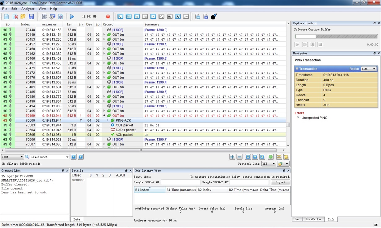

      I meet unexpected PING-ACK issue when usb host transmit special data packet via usb analyzer.The issue may only occur when the follow conditions are established:
1.A hub is connected to usb host
2.The data packet is transmitted from host to device,and filled with fixed data(0x47).The issue maybe reproduced with other fixed data.
   I use the wince OS.However,I meet the same issue on EVM board with linux os.
    The issue will not occur if we remove hub.The issue can't be reproduced with the same hub on other CPU IC(IMX28(USB2.0),and S3C2416(USB1.1)).It's strange.

  • Xing,
    Please check the information of the OUT transaction right before the PING-ACK, and pay attention to the data toggle in the OUT data packet. I guess what happened was that the previous OUT transaction failed, then host PING the device, and re-transmit the same OUT data packet again.
    The index #70504 shows the data toggle is DATA1. If the data toggle in index #70495 is DATA1 too, my guess above is correct. Otherwise, please attach the bus trace and let me take a look.

    Thanks a lot!You are right.The data toggle of the out packet is incorrect .However,I feel doubt this issue can't occurs if the data packets is filled without fixed data.Moreover,the data toggle is read from TXCSRH register when  the TX interrupt of the previous  packet is triggered.The usb host driver will record the data toggle if data packet is sent successfully.I don't know how to check it again in host drivers.

    That is right, it only happens with such fixed test pattern (0x47, 0x43), and will not happen in real data transfer. In fact, this is not an issue at all. It is just a re-transmit of the previous transaction, this is defined in the USB Specs to ensure the transfer.

       I think it's right the PING-ACK is due to re-transmit.However,do you know why the fixed test pattern will make the OUT transaction failed much more frequently?I can't duplicate this issue with other CPU IC.so I  think it's not a common issue.
  • This is not a question I can answer as a SW guy, but I guess it is something in the USB PHY analog.

  • This is very likely caused by reflection on the DP/DM pair. Certain patterns can exacerbate bus errors by introducing reflections that can confuse one (or both) ends of the connection. Changing the nature of the transmission path by adding/removing devices and/or cables also changes the timing of any reflection which can help/hurt overall functionality.
    Keep in mind that there is no such thing as a perfect transmission path. Every topology instance (board, device, PHY, cable, etc.) is different in some way, even with "identical" components. This is understood in the USB specification and as such USB-IF compliance windows are presented rather than hard compliance targets. Every compliant device will fall differently within this compliance window. Also, USB protocol was designed to be robust to ensure that the inevitable bus error could be gracefully recovered from, which is evidenced in the protocol trace you've provided.
    If you feel that the issue you've described is one that negatively impacts bus performance to an unacceptable degree in your design, my recommendation is that you review the TI High Speed Layout Guidelines white paper and look for board issues that may help reduce the introduction-of and sensitivity-to bus noise and reflections.
