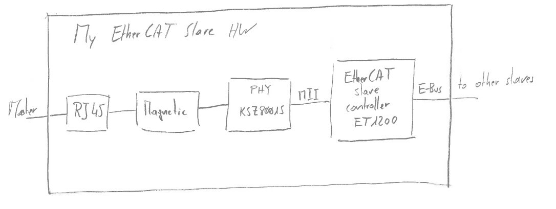

I'm trying to use the PRU-ICSS as the ethernet interface for an EtherCAT master application.
The HW is the PCM-953 carrier board for phyCORE-AM335x of Phytec.
The Linux kernel PRU driver is coming from this repository:
git://git.phytec.de/linux-ti branch origin/v4.4.15-phy
Note that if I use the PRU-ICSS ethernet interface with some standard protocols (IP, TCP, DHCP, ...), it works without any failure.
In the case I use this interface for an EtherCAT master application (an EtherCAT frame is sent every 10ms), it doesn't work as expected. If I connect directly the PRU-ICSS to an EtherCAT slave through an Ethernet cable (crossed or not crossed), it doesn't work!!! There isn't any interrupt generated by the PRU firmware (checked with "cat /proc/interrupts"). It seems that the PRU firmware is frozen because there won't be anymore interrupt generated, even if I connect this interface to my computer to get an IP address though my DHCP server (what it works very well if I reboot my target!).
In the case I use the CPSW ethernet interface instead of the PRU-ICSS interface, it works very well. My EtherCAT master application runs without any failure.
In the case the EtherCAT master and the slave are connected trough a LAN switch, it also works very well (even with the PRU-ICSS)! 100 interrupts per seconds are generated.
I cannot find any explanation! According ethtool the interface is correctly configured (100 Mbit/s, full duplex). Note that the EtherCAT frame is sent and received back almost simultaneously (~1 microsecond delay).
Thanks for your help

    I don't await from TI any EtherCAT master solution. My problem has nothing to do with EtherCAT. It is a pure ethernet problem.
    What I need from TI is simply a PRU ethernet firmware which behaves as another ethernet kernel driver.
    My test:
    I send an ethernet frame to an external device which reply the same frame except that the sender MAC address is not the same one. The delay between the request and the reply is very small ( < 1 microsecond).
    Results:
    In the case I send this frame over the CPSW interface, it works perfectly (I receive the replied frame as expected).
    In the case I send this frame over the PRU interface, which is first connected to a LAN switch, it works also perfectly.
    In the case I send this frame over the PRU interface connected directly to the external device, it doesn't work (no reply received and the PRU doesn't at all anymore).
    Questions:
    Is it possible for the PRU ethernet firmware to simultaneously send and receive ethernet frame?
    Is there explanation about the different behavior between a standard ethernet kernel driver (CPSW) and the PRU firmware?
    Is it possible that there is a bug in the PRU ethernet firmware?
    Is it any chance that my test can work with the PRU?

  • Could you please provide a more explanation of what this test is trying to accomplish? If you are changing the sender MAC why not the dest MAC?
    Answer to Questions:
    - Is it possible for the PRU ethernet firmware to simultaneously send and receive ethernet frame? Yes, the firmware supports a full duplex link capability. This of course depends on the Ethernet  PHY having been setup or auto-negotiated to a full duplex configuration.
    - Is there explanation about the different behavior between a standard ethernet kernel driver (CPSW) and the PRU firmware? Not at the moment if I understand this setup correctly. The PRU is going to drop unicast packets that aren't addressed to it at the link layer. Which is why the question above of if the sender MAC is changed why not the destination MAC. It is surprising that the cpsw is accepting these packets. How is the reception being accounted for? What is the configuration of the cpsw, switch or dual mac? TI board? What application are you using to send the packets?
    - Is it possible that there is a bug in the PRU ethernet firmware? Bugs are always a possibility but there are not any that we are aware of at the moment.
    - Is it any chance that my test can work with the PRU? The test that you are performing will need to be understood better. There may be another way to test what you are trying to accomplish.

  • Thanks for your answers,
    First of all, here are the responses to your questions:
    The ethernet frame I send is a broadcast request (destination mac address ff:ff:ff:ff:ff:ff).
    Ethtool shows me that the PHY did its work correctly (100Mbit/s and Full duplex in all of my test cases).
    The CPSW driver is configured as dual mac.
    I confirm that my problem concerns the same project as this post: e2e.ti.com/.../547917
    The master EtherCAT stack is: Igh EtherCAT Master for Linux. But I don't wait help from TI about the EtherCAT master side.

  • This file (to be opened with wireshark) shows the ethernet frame which is sent and replied (with change in the source MAC address). It shows also that the sender mac address is set to the broadcast address.
    The question is: Should the PRU generate an interrupt with such case? The answer is yes with a LAN switch between the EtherCAT master and its slave, and the answer is no in the case the EtherCAT slave board is directly linked to the master.
    In the meantime, I continue to make investigations. And I found with ethtool (option -S) that I have so many rxMisAlignmentFrames as awaited received frames. What does it means?
    Many thanks in advance for your help

    I'm still investigating around this problem.
    I found the following procedure which systematically disturb the PRU ethernet firmware:
    - Connect my EtherCAT slave module directly on the PRU network interface (eth2)
    - Power ON the EtherCAT slave module and the TI AM3359 master board
    - Send an ICMP request over the PRU network interface (this request will be looped back by my EtherCAT slave)
    From this time, the PRU firmware won't work anymore! I can reconnect the PRU interface to a PC with a DHCP server and starting a DHCP client, but I never receive any IP address (what is working well if I reboot my infrastructure). The PRU won't generate any interrupts!
    If I play the same scenario with CPSW interface (eth0) instead of the PRU, it works
    Here are the traces of the scenario played over the PRU network interface (will block the PRU firmware!):

  • ... and my EtherCAT slave HW looks as follow:
  • Hi Laurent,
    but we need to know how the packet looks like that is screwing up the firmware. Usually EtherCAT is not designed to support ICMP frames. Also we do not have your slave hardware as it seems to be special. We could try to debug using some Beckhoff slaves as they also have similar IP.
    Anyway you will need a TAP (network trace tool such as Hilscher sells) to capture packets. Using a PC or switch in between will not work as they may drop any errored packets.
    I will try to look into your Linux references next week and see if we can identify the PRU firmware versions. We can then try some basic tests with our ICSS EMAC setup and see how it reacts to ICMP packets. But I assume this to work as I have used that in standard Ethernet connect tests without any issues. I could use all kind of protocols based on TCP/IP (FTP, telnet, SCP,...) and usually the connected PC also sends all kind of packets in a standard Ethernet network config.
