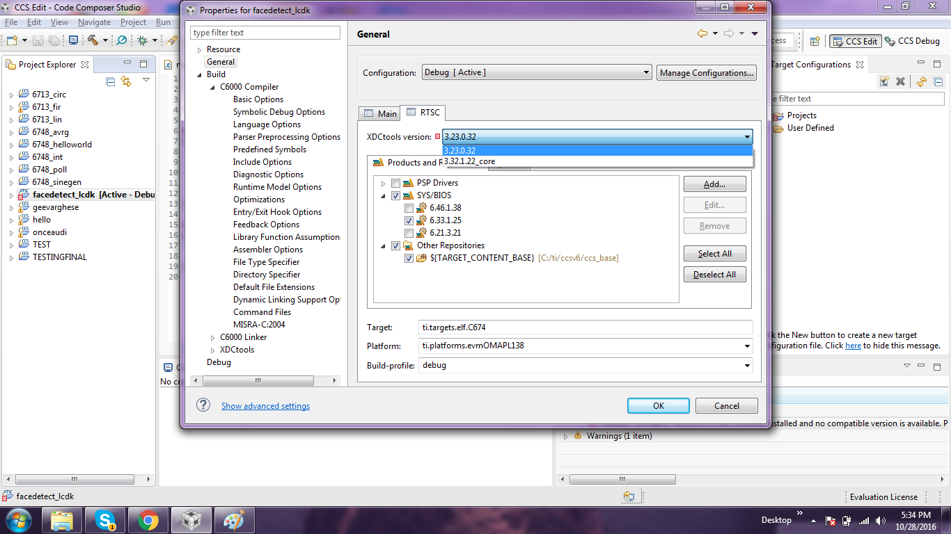

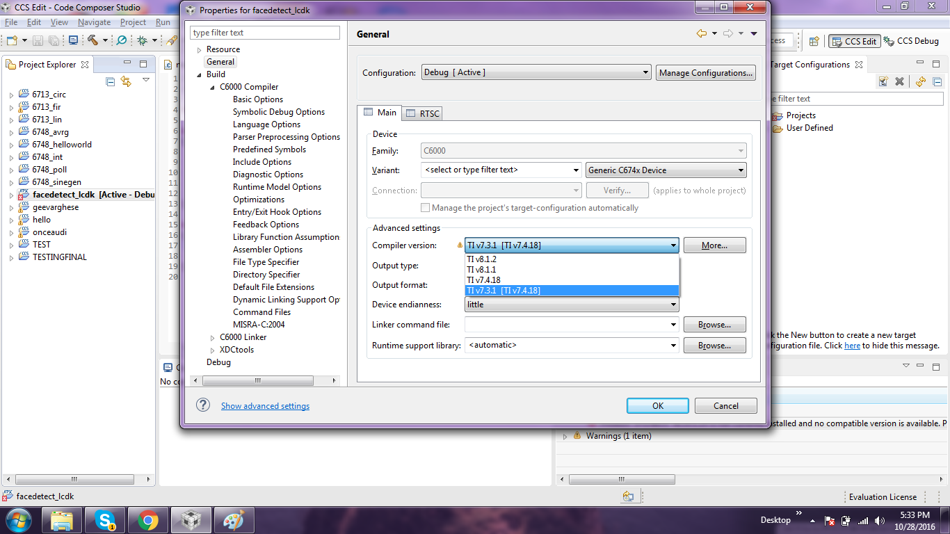

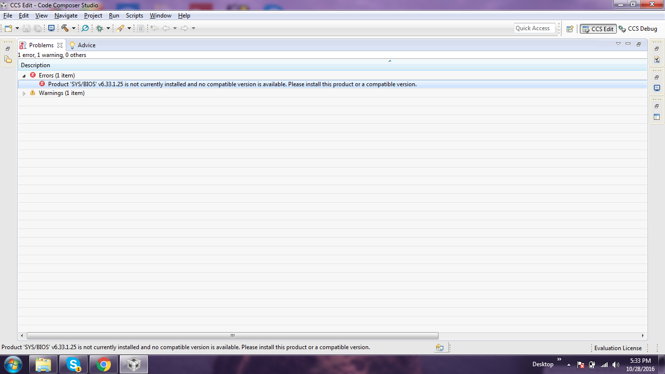

Dear sir,
I am working with LCDK6748 with CCS6.2,i am doing standard program Face detect,there when i import it was showing about XDS tools error,compiler error .........see the screen shots and let me know the changes.
I have changed XDS tool version and compiler versio..............but result is same.........
thank you.

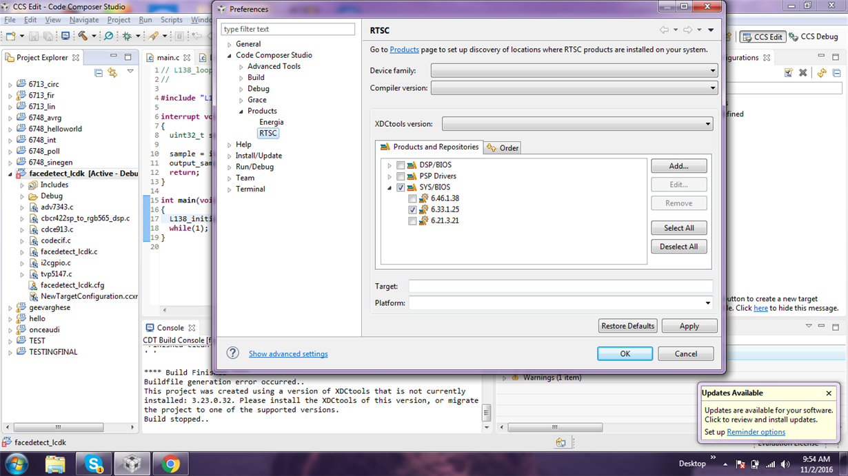

  • Hi Mohammad,
    Can you open "Window"->"Preferences" window, then select "Code Composer Studio" ->"RTSC"->"Products" and share a screenshot of the window ?

  • Hi Ashish,
    Here is the screen shot,i have selected and tested all the sys/bios  but still i got the same error.
    thank you.

  • Mohammad,
    The error indicates that the XDC Tools version 3.23.0.32 has not been installed or detected by CCS so when you imported the project CCS is not able to locate any compatible version of XDCtools 3.23.0.32. As you can see the XDCtools required to build SYSBIOS project is blank in the RTSC configuration. It appears that you only have version 3.32.122.core installed and this is incompatible with the version of SYSBIOS that you are using.
    The facedetect was part of the C6 SDK for this device. Have you installed the entire SDK in C:\ti location or in a custom location on your windows machine? If you have installed it in a custom location then you need add that path to the CCS discovery path as shown here :
    processors.wiki.ti.com/.../Processor_SDK_RTOS_Setup_CCS
    Please see if the your issue is resolved after the XDCtools 3.23.0.32 is discovered by CCS.
    Rahul

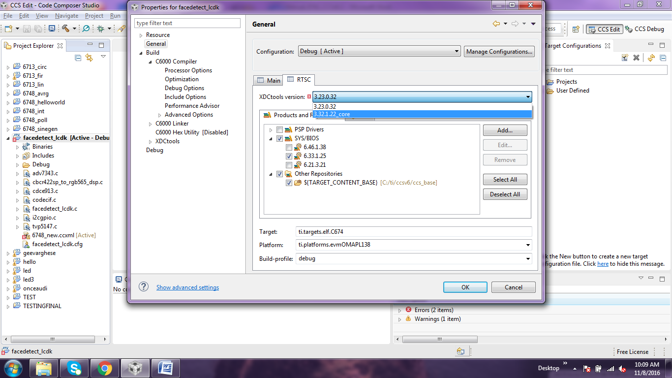

  • Hi Rahul,
    I have selected and tested again,but the result is same.
    yes.
    But am getting the same error,how to resolve this issue.
    thank you.
  • Mohammad,
    It will help if you can provide the version number of the components that you have selected in the RTSC configuration. XDCtools/SYSBIOS are sensitive to component version alignment so it would be good if you can tell us the version numbers of components.
    The SDK that you are using was released 2-3 years back and was tested with the components specified in the release notes. To test this with newer CCS and component version, we will need to understand your setup and reproduce the issue at our end so please provide as much detail regarding your setup and we will try to help you with your setup.
    Rahul
  • Hi Rahul,
    I am using XDS tool 3.23.0.32 and SYS/BIOS 6.46,6.33,6.21.............i have used all these while trying.
