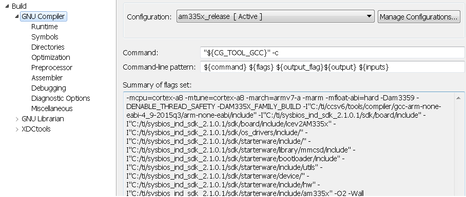

    Can you specify what boot mode you are using ? Most projects in ISDK have a project dependency on the board library so you need to import that library project in the workspace. Once you import you should be able to see the project settings. Here are the project settings:
    Build configurations: am335x_release
    Main
    Family :ARM
    Variant  ICE_AM3359 [Cortex A]
    compiler version: GNU v4.8.4
    Device Endianness: little

    Screen shot for Compiler that includes runtime and symbols:

  • Hi BZ
    Regretfully the SYSBIOSSDK-IND-SITARA 02_01_02_02 and the included  starterware applications, like the bootloader, are configured for only the AM3359 ICE v2 and the AM4379 IDK EVMs.
    The boards that are supported by SYSBIOS Industrial SDK 02.01.02 are described in the Release Notes at http://processors.wiki.ti.com/index.php/SYSBIOS_Industrial_SDK_02.01.02_Release_Notes#Device_Support
    This section also contains other configuration requirements for projects that are contained in SYSBIOSSDK-IND-SITARA 02_01_02_02
    These are:
    Code Composer Studio version CCS 6.1.2.00015
    Compiler GNU v4.8.4 (Linaro)
    SYS/BIOS 6.45.01.29 Real Time Operating System
    XDC Tool 3.32.00.06
    NDK 2.24.3.35
    Different versions of CCS can be downloaded at: http://processors.wiki.ti.com/index.php/Download_CCS  When it is necessary to maintain different versions of CCS – one method is to install them in separate directories. The CCS 6.1.2.00015 will download the GNUv4.8.4 when the load gnu compiler option is selected.
