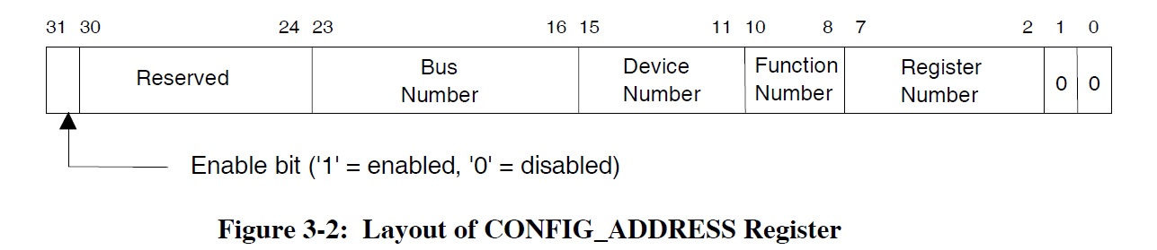

We have  two C6455 DSP's and a processor connected via PCI  Local bus interface
Where one DSP is the master/host and other DSP & processor will be the peripherals.
AD31 is used for DSP2 and AD30 is used for the processor as IDSEL
Following are the settings done at the master side.
1)  "BUS_MS" bit  is set in the PCICSR register
2) Configuration read as below
unsigned int pci_read_config (int addr, int busno, int devno, int funcno)
unsigned int bno_bit = (busno << 16);
unsigned int dno_bit = (devno << 11);
unsigned int fno_bit = (funcno << 8);
unsigned int adr_bit = (addr & 0xfc);
/* Check READY bit */
while(1)
if(*PCIMCFGCMD & 0x80000000)
break;
*PCIMCFGADR = 0x80000000 | bno_bit | dno_bit | fno_bit | adr_bit;
*PCIMCFGCMD = 0x00000001;
while(1)
break;
return *PCIMCFGDAT;
Following are the observation/issues.
1) while performing configuration read (Type 1) , for any device number  from 0x0 to  0x1F  DSP 2 is responding
2) If unplug the DSP2 from the backplane , then PCIMCFGCMD register's READY bit will never set to one in the first loop itself
Please suggest if any setting needs to be done at the master and slave side.
