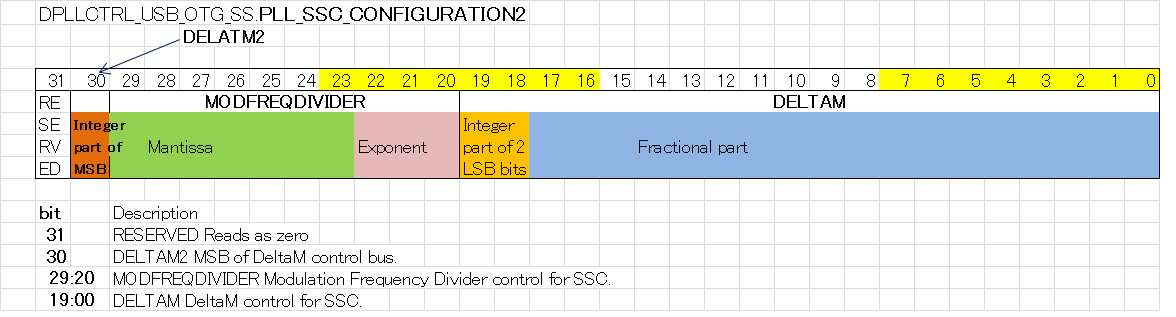

I have one question regarding USB3.30 SSC( Spread Spectrum  Clocking ).
According to the USB3 PHY Subsystem section of TRM of AM5728,  it is written in the below.
       The SSC can be enabled and disabled by asserting the
       DPLLCTRL_USB_OTG_SS.PLL_SSC_CONFIGURATION1[0] EN_SSC bit.
For enable SSC of USB3, is only set the EN_SSC bit? Is there any special sequence?
Please let me know.
