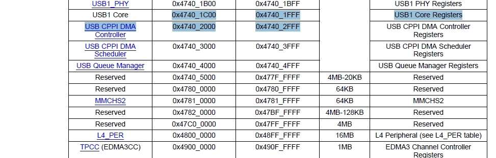

  When tracing at the file C:\ti\AM335X_StarterWare_02_00_01_01\drivers\usb.c file, in the function USBHostPwrConfig, we found that this read part marked as below is out of the memory of USB1_CORE.
  Original function:
void  USBHostPwrConfig(unsigned int ulBase, unsigned int ulFlags)
        /* Check the arguments. */
        ASSERT((ulBase == USB0_BASE)||(ulBase == USB1_BASE));
        ASSERT((ulFlags & ~(USB_EPC_PFLTACT_M | USB_EPC_PFLTAEN |
        USB_EPC_PFLTSEN_HIGH | USB_EPC_EPEN_M)) == 0);
        /* If requested, enable VBUS droop detection on parts that support this
        * feature. */
        HWREG(ulBase + USB_O_VDC) = ulFlags >> 16;
        /* Set the power fault configuration as specified. This will not change
        * whether fault detection is enabled or not. */
        HWREGH(ulBase + USB_O_EPC) =
        (ulFlags | (HWREGH(ulBase + USB_O_EPC) &
        USB_EPC_PFLTSEN_HIGH | USB_EPC_EPEN_M)));
The two definitions are as below:
#define SOC_USB_1_BASE (0x47401C00) ,
#define USB_O_EPC 0x00000400  ;
So the read part's value HWREGH(ulBase + USB_O_EPC) is HREGH(0x47401C00 + 0x00000400  ) = HWREGH(47402000
This is out of USB1_CORE's memory. Is this an issue?
