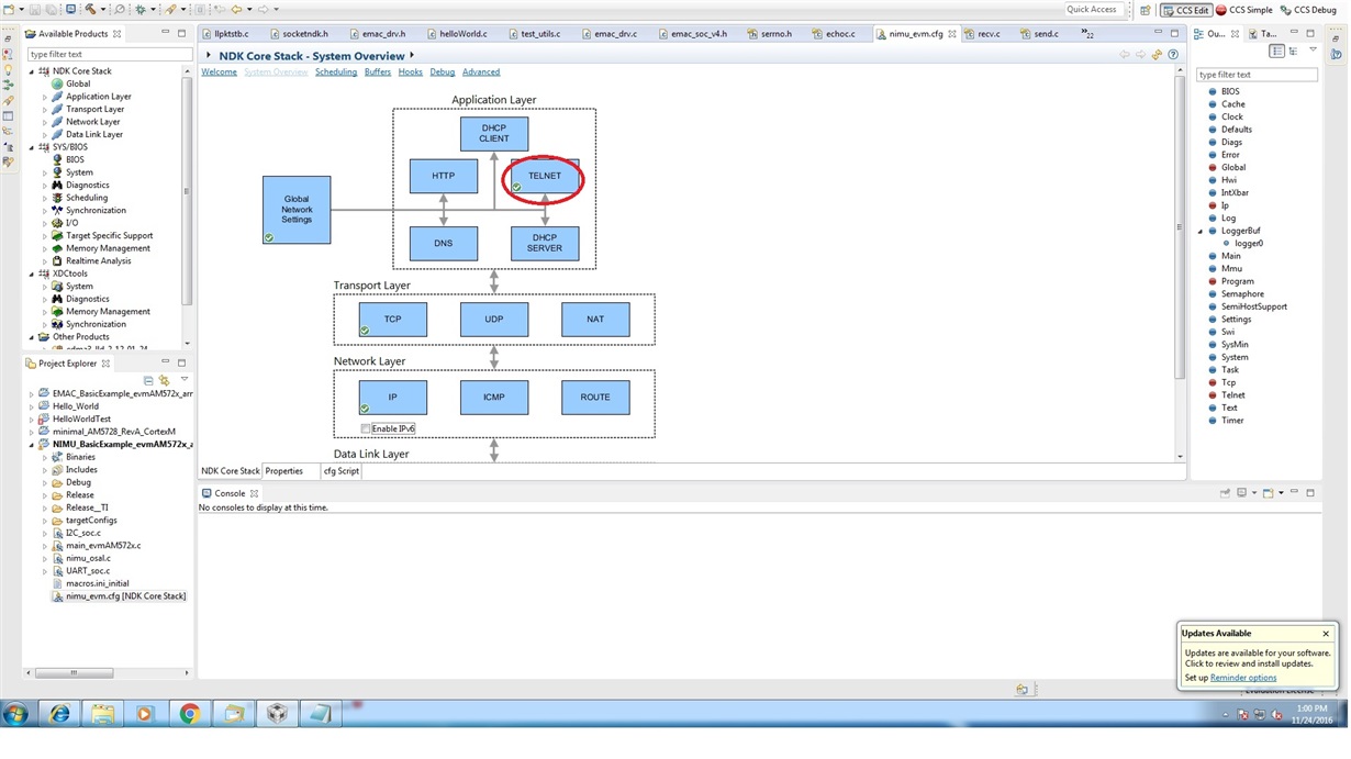

  • Anjana,
    Please refer to section 3.5.1 Troubleshooting Common Problems, in "TI Network Developer's Kit (NDK) v2.24 User's Guide", spru523i.
    All socket calls return “error” (-1)
    • Make sure there is a call to fdOpenSession() in the Task before it uses sockets, and a call to
    fdCloseSession() when the Task terminates
    Regards, Garrett

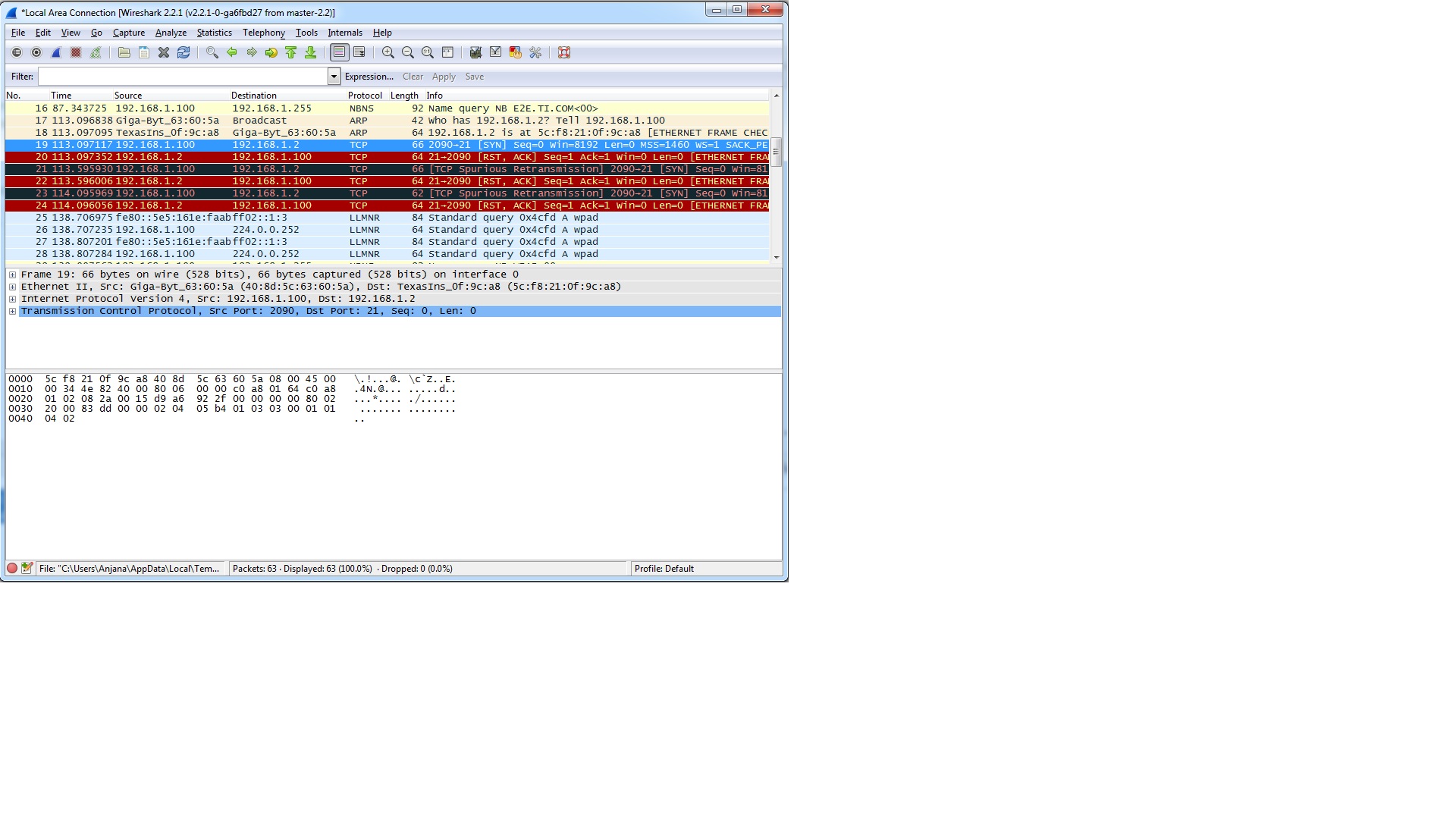

  • Thanks Garrett,
    I did the changes in NIMU example to send data after refering NDK user guide spru523i. But not able to send data. Attaching the code of modified NIMU_BasicExample_evmAM572x_armExampleproject. Configuring NDK with XGCONF. Please suggest where i am going wrong.

    void SendDataToPC()
    SOCKET s = INVALID_SOCKET;
    struct sockaddr_in sin1;
    // struct sockaddr_in sin_bind1;
    int I,test=125;
    char *pBuf = 0;
    struct timeval timeout;
    // Allocate the file descriptor environment for this Task
    fdOpenSession( (HANDLE)Task_self() );
    NIMU_log("\n== Start TCP Echo Client Test ==\n");
    //NIMU_log("\n== Start UDP Echo Client Test ==\n");
    // Create test socket
    //s = socket(AF_INET, SOCK_DGRAM, IPPROTO_UDP);
    s = socket(AF_INET, SOCK_STREAM, IPPROTO_TCP);
    if( s == INVALID_SOCKET )
    NIMU_log("failed socket create (%d)\n",fdError());
    goto leave;
    // Prepare address for connect
    bzero( &sin1, sizeof(struct sockaddr_in) );
    sin1.sin_family = AF_INET;
    sin1.sin_addr.s_addr = inet_addr(IPAddr);//inet_addr(SERVER_IP);//htonl(-1);
    sin1.sin_port = htons(7);
    /*bzero( &sin_bind1, sizeof(struct sockaddr_in) );
    sin_bind1.sin_family = AF_INET;
    sin_bind1.sin_addr.s_addr = inet_addr(LocalIPAddr1);//IPAddr;
    sin_bind1.sin_port = htons(1025);//htons(7);
    if( bind( s, (PSA) &sin_bind1, sizeof(sin_bind1) ) < 0 )
    NIMU_log("failed bind (%d)\n",fdError());
    goto leave;
    else
    {NIMU_log("bind succesful\n");}*/
    // Configure our Tx and Rx timeout to be 5 seconds
    timeout.tv_sec = 5;
    timeout.tv_usec = 0;
    if(setsockopt( s, SOL_SOCKET, SO_SNDTIMEO, &timeout, sizeof( timeout ) ) < 0 )
    NIMU_log("failed Socket opt(%d)\n",fdError());
    goto leave;
    else
    {NIMU_log("Socket opt succesful\n");}
    setsockopt( s, SOL_SOCKET, SO_RCVTIMEO, &timeout, sizeof( timeout ) );
    // Connect socket
    if( connect( s, (PSA) &sin1, sizeof(sin1) ) < 0 )
    NIMU_log("failed connect (%d)\n",fdError());
    goto leave;
    // Allocate a working buffer
    if( !(pBuf = malloc( 125 )) )

  • In above attach code i am not able to send data using TCPIP protocol to PC
    The snapshot of my config nimu_evm.cfg file, do i need to do some changes in this file for TCPIP communication.
    /* ================ General configuration ================ */

  • Did the changes as suggested. also attached the wireshark capture return value of send is 4: EINTR           4       // Interrupted system call
     I get the following console output:
    [CortexA15_0] Using MAC Address: 5c-f8-21-0f-9c-a8
    Network Added: If-1:192.168.1.2
  • I am not able to receive data from evmAm572x on TCPIP to PC(application used is telnet to receive data). I did the changes as you mentioned.
    I am getting response as of  send(.............) as 4  // Interrupted system call.
    1. Please suggest if i need to do any other changes in file(nimu_cfg/other network open or configuration file)
    2.Which tool shall i use to test the TCPIP communication?
    Attaching my code also

    From the wireshark trace, it appears the packets have been transmitted to wire/PC. To receive the packet data, you need a similar socket receive application other than Telnet in PC. There are a few window socket apps in ndk_2_24_x_y\packages\ti\ndk\winapps, for example, recv.c/recv.exe. To establish Telnet communication, you need to develop a Telnet server/client on the EVM.
    Regards, Garrett
  • Hi Garrett,
    I developed TCPiP client on the EvM defined port 23 the source code I attaced in my last communication.
    When i run this code using target debugger. i got send(..) response as number of bytes send, means it trys to send data for approx 20 iterration but after that the response of send(..) changes to error code 35 /* Operation would block */ and then 57 /*Socket is not connected */ .
    The window socket apps in C:\ti\ndk_2_24_03_35\packages\ti\ndk\winapps recv.c and send.c both are prograamed as TcPIP client. when i am trying to run recv.exe (cmd: recv.exe 192.168.0.254 23 ) it is giving failed connect error 10060.
    I am attaching the NIMU system overview
     Is the configuration is correct. Hre telnet is selcted what dose this means?
  • Anjana,
    You don't have to enable Telnet server for just verifying TCP/IP socket connection. For Telnet configuration, please check these threads:
    e2e.ti.com/.../327369
    e2e.ti.com/.../343931
    Garrett
