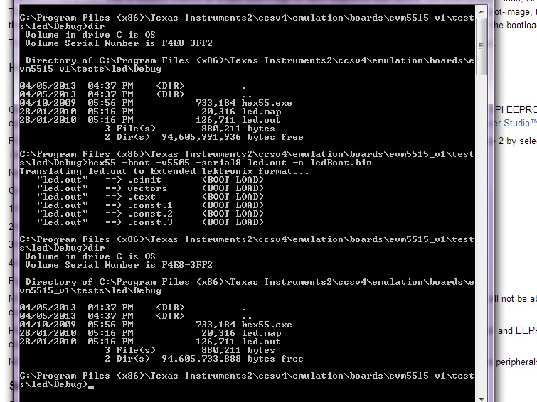

    I am using the C5515EVM and trying to boot an image file on the NAND Flash. I use the hex55 command and get the expected output from the program. But I cannot see the new file created. Attached is a snapshot of my command prompt before and after running the code. I have ensured that the directory is not write protected. Any help would be highly appreciated.
    I have also used the "-b" option on the hex55 code but still failed to create the .bin file.
    Dipanjan
  • I cannot see anything wrong with it. Attached is my try with exact command. Do you have another PC to try?
    8461.hex55.rtf
