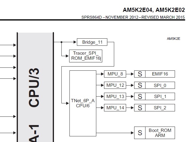

  • Rahul,
    thanks for your answer.
    Are sure that this really can happen?  Let's take a look at the HW diagram from the Keystone spec:
    So let's assume 2 CPU cores issue a 32-bit read transacation each (at the same time). I'd expect that a 32-bit transactions is"atomic" on the TeraNet switch and thus should be properly serialized the interfaces which lead to the EMIF16.
    Which hardware instance would be responsible for transforming this into a sequence of 4 interleaved 16 bit transactions?
  • The diagram somehow got lost in my lastt post
