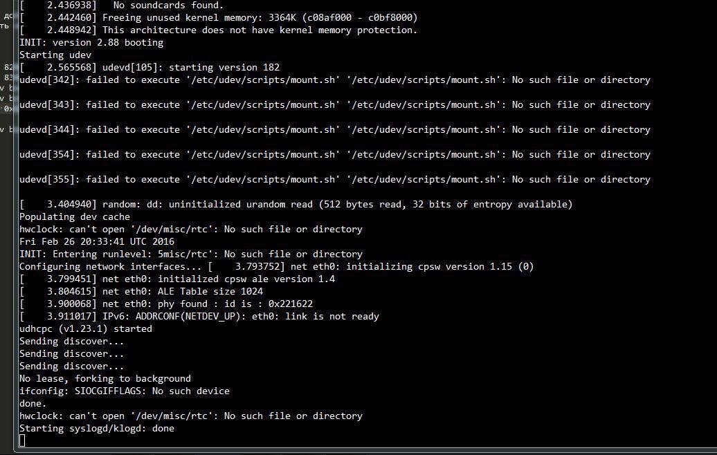

  • It's ok, now kernel is booting with following bootargs: setenv bootargs console=ttyO2,115200n8
    But it hangs on this moment
    Did I correctly understand, that problem is in FS initialization?

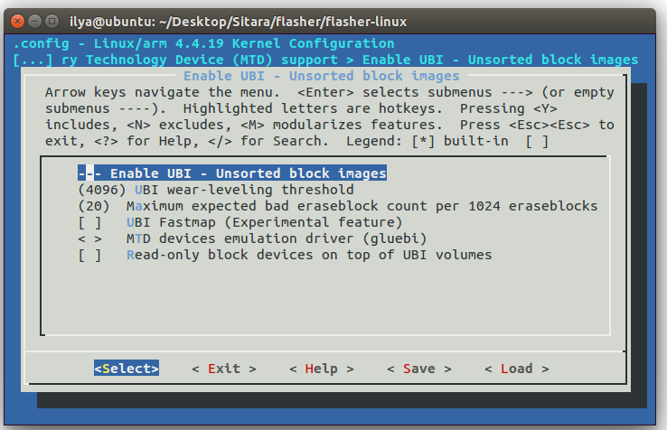

    2. You should run make menuconfig to enable these options if they are not present in the .config.
    processors.wiki.ti.com/.../Sitara_Linux_Training:_Linux_Host_Configuration
  • There is no same fields
  • Check the General setup section.
