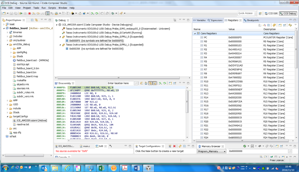

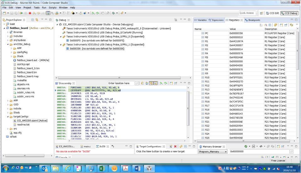

but Both of PRUs often do not response on their target board.
then ARM core is working.
I show you PRU0 and PRU1's screen shot
It means PC of PRU is loop.
I need to fix this issue.
Please let me know about these question.

  • Hi Hiroyasu-san, answers below:
    1) yes that is correct, firmware used is profibus_pru0_main_bin.h and profibus_pru1_main_bin.h
    2) There are few reasons, one is for certification. Any modification would require re-certify the protocol
    3) I don't think we can give you the source code, but I will check with the developers which other options for debugging we can offer
    4) Apologize, I don't know which loop could be ..

    I showed you screen shot PRU loop.
    In this case, Can you tell me register and Flag PRU provide ? if device have.
    and What information do you need to resolve reason why PRU is stopped ?

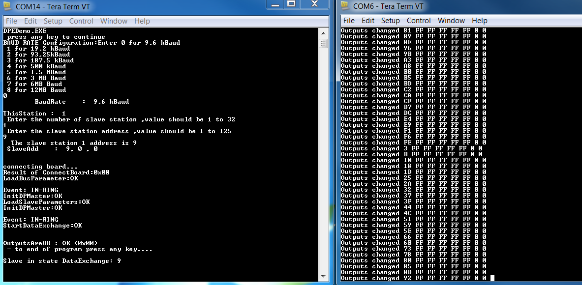

  • Hiroyasu-san, I think I was able to reproduce the issue after 2 hours and a half using 1,5Mbaud. My Profibus Master reported "Slave out of state DataExchange". and in my slave I see:
    Outputs changed 33 FF FF FF FF FF 0 0
    Outputs changed 0 0 0 0 0 0 0 0
    I will confirm and let you know. Thank you.
