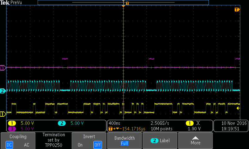

Here is a view showing the CS (magenta), CLK (blue) and MOSI (yellow):

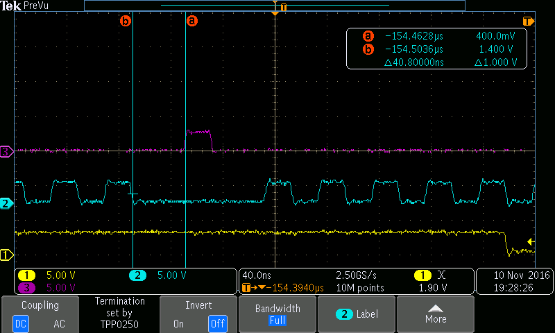

Clock cycle measurement, showing more than 40ns clock cycle time:

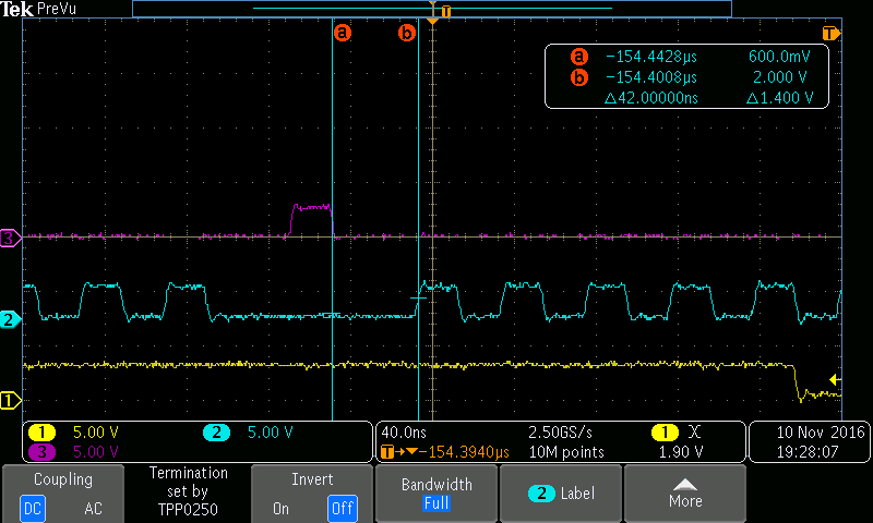

Timing from chip select assert to first clock edge (OMAP requirement seems to be 5.88ns)
Timing measurement for last clock edge to CS de-assert (OMAP requirement seems to be 8.4ns)
