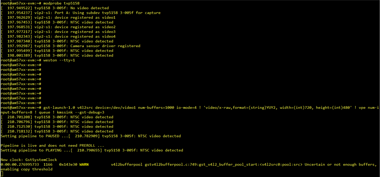

Ti,there is a tvp5158 on the vin4a port of my custom am5728 board.I use the command to capture the video:
gst-launch-1.0 v4l2src device=/dev/video1 num-buffers=1000 io-mode=4 ! 'video/x-raw,format=(string)YUY2, width=(int)720, height=(int)480' ! vpe num-input-buffers=8 ! queue ! kmssink --gst-debug=3
But it stop!What the reason would be?
And I want to know that whether any other way(somethings like dm8148 saLoopBack tool) to debug?I found that using the gst-launch-1.0 is not easy!
BR,
vefone

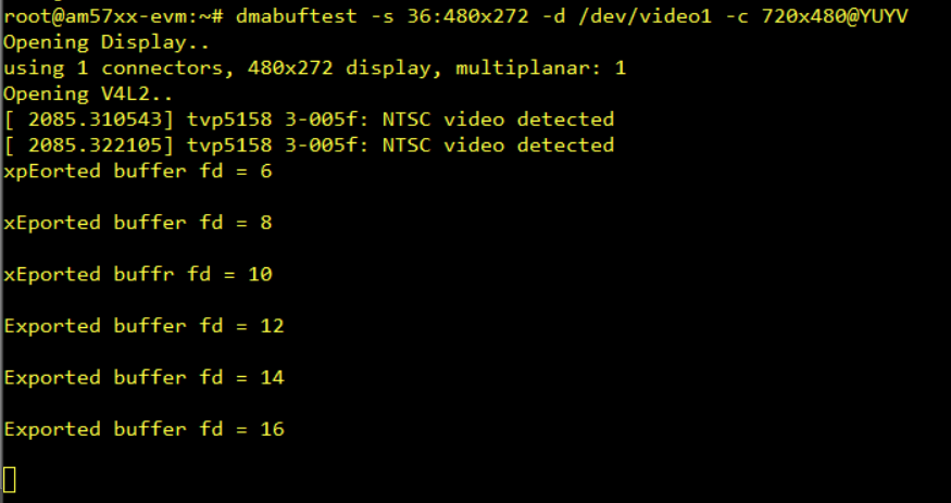

    Quote,I use "dmabuftest -s 36:480x272 -d /dev/video1 -c 720x480@YUYV",I can not see somethings on the display.

    vefone said:
    gst-launch-1.0 v4l2src device=/dev/video1 num-buffers=4000 io-mode=4 !
    Num-buffers property does not mean that you are increasing buffers. It means "capture 4000" frames.
    If it is not set it means that it will capture frames until ctrl+c.
    Could you try :
    gst-launch-1.0 v4l2src device=/dev/video1 num-buffers=100 io-mode=4 ! 'video/x-raw,format=(string)YUY2, width=(int)720, height=(int)480' ! fakesink
    BR
    Margarita
    Are you sure that 36 is the right connector ID?
    Could you try to set io-mode=2?
    BR
    Margarita
    Margarita,I use the "modetest" to get the connector ID,here is the log:
    The resolution of my LCD is 480*272,is the connector ID right?
    After I set io-mode=2,the result is same as the "io-mode=4".
    Any idea? is there a v4l2 tools to test it?
