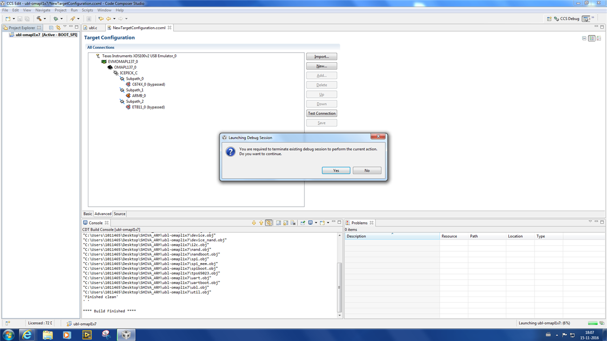

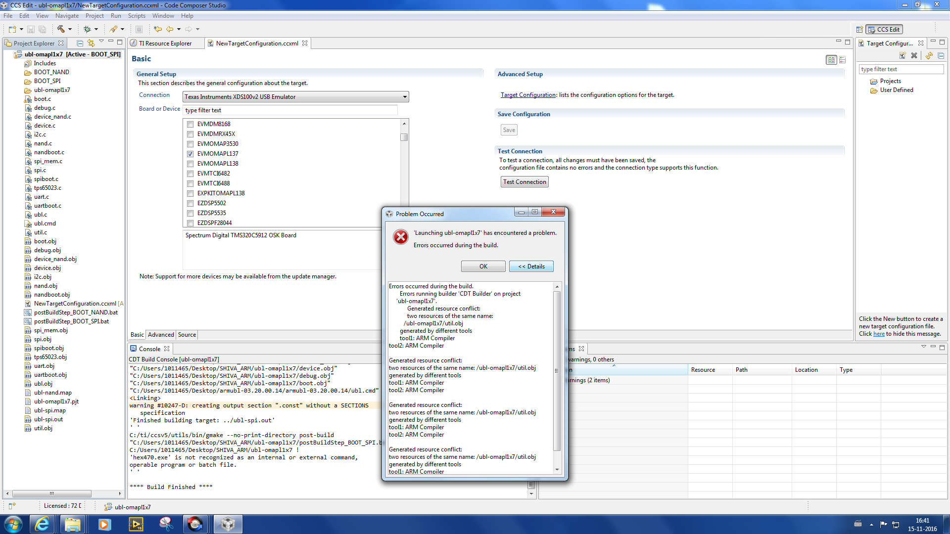

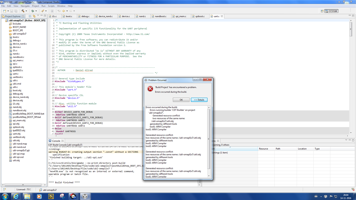

  • Hi Titu
    Thanks for your support
    I am able to build the code by the source provided by you
    But once I press the debug icon I get the following error should I delete the files BOOT_NAND????NOT SURE
    I tried deleting the  folder BOOT_NAND  & postBuildStep_BOOT_NAND  .but  I STILL GET ERROR
    Thank you
    Deepak R
  • Hi
    Titu
    Thanks for help!!!!!!!!!!!!
    Finally able to resolve the conflict I changed the optimization options to off so I don't get the error when I try to do and clean and build this
    But my end result remains same I am not able to connect to the board in inline debugging as I have done for dsp I get the following error
    Error connecting to the target:
    (Error -1063 @ 0x0)
    Device ID is not recognized or is not supported by driver. Confirm device and emulator configuration is correct, or update device driver.
    (Emulation package 5.0.747.0)
  •  Adding extra information I am trying to change these subpath_x and trying to find if any configuration is wrong!
    I don't have any debug configuration enabled
    pfa for reference
    Thank you
    Deepak R
  • Adding extra info
    As am I trying to debug should I enable any slave processot tick on subpath!!!!!!??????????????????
