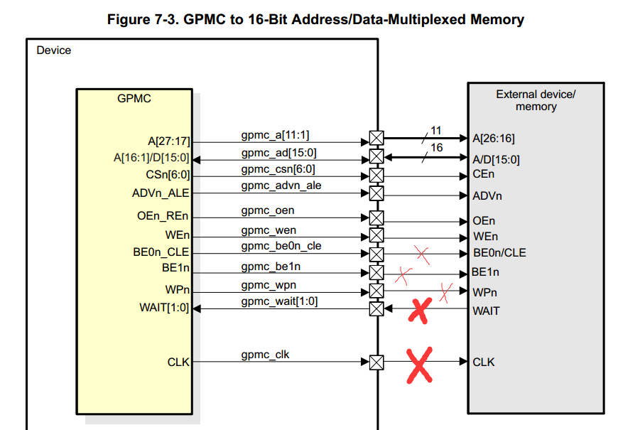

Asynchronous Single-Read /write  Operation on an Address/Data Multiplexed Device.
I am using AM3354 processor & connecting it to NOR flash of Multiplexed address data 16bit.

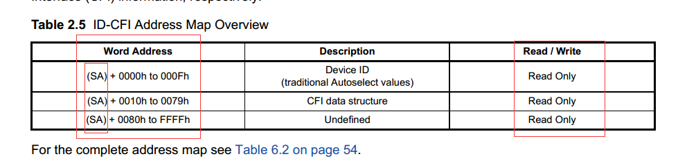

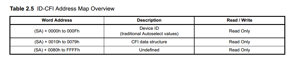

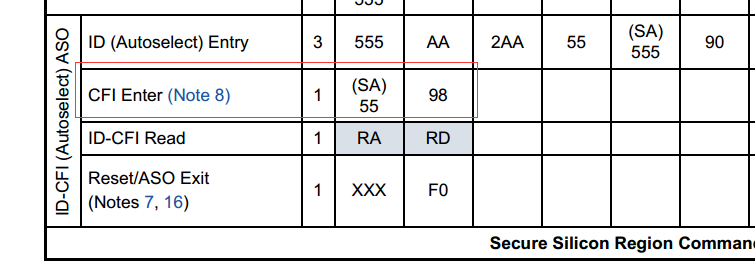

For example:
/* Example: CFI Entry command */
*( (UINT16 *)base_addr + 0x55 ) = 0x0098; /* write CFI entry command */
/* Example: CFI Exit command */
*( (UINT16 *)base_addr + 0x000 ) = 0x00F0; /* write cfi exit command */
CFI Entry command is stop.
And no lower cs0(CE#) signal.
I know this kind of phenomenon is not right.

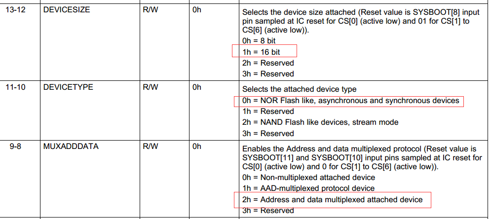

 My configuration:

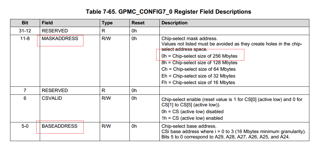

Chip-select base address  = 0x2000000
#define CONFIG_SYS_FLASH_BASE     0x2000000    /*SA*/
#define STNOR_GPMC_CONFIG1  0x00001200 ; DEVICESIZE = 1h  ,  DEVICETYPE = 0h ,  MUXADDDATA=2h

#define STNOR_GPMC_CONFIG7  0x00000042  //base addr = 0x2,   MASKADDRESS= 0x0    /*256MB*/
 Now I don't know why I can't get FLASH ID.
I think is a problem of flash address configuration, but I'm not sure.
