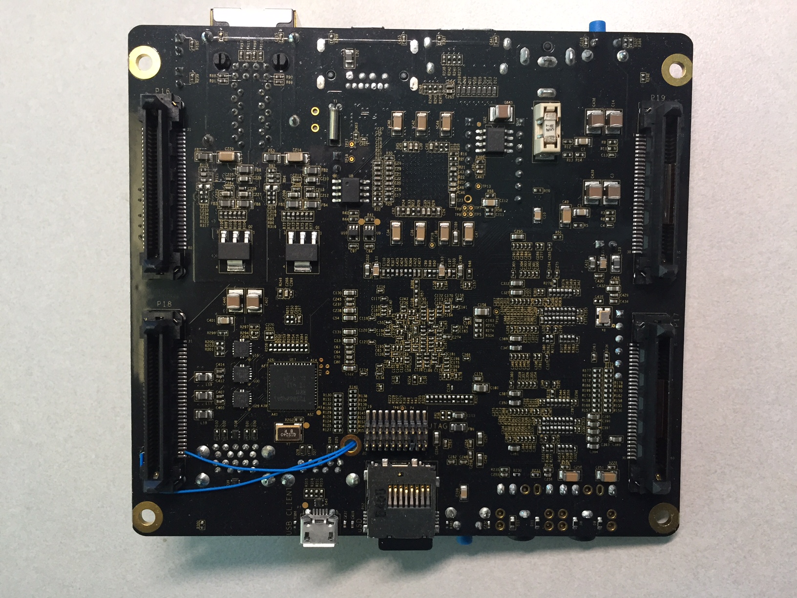

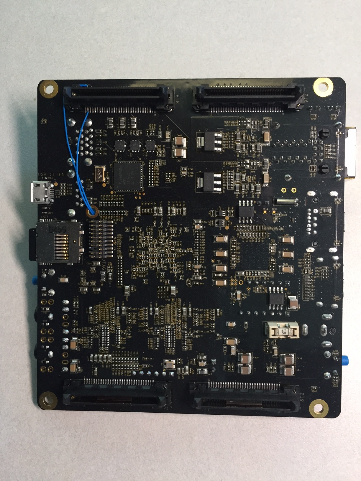

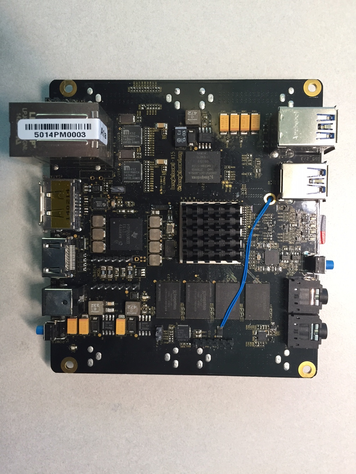

  • Could you post a picture of both sides of the board?
    That data loss is really high for the bit rate being used.
    Could you also post the command lines used for both the client and server sides of iperf?
    Could you also post just ethtool eth0 results too please?
  • Board pictures are attached.
    Server command (on board):  iperf3 -s
    Client command (on PC, attached via dedicated gig-E link): iperf3 -c 192.168.254.4 -u -b 100M
    Ethtool output:
