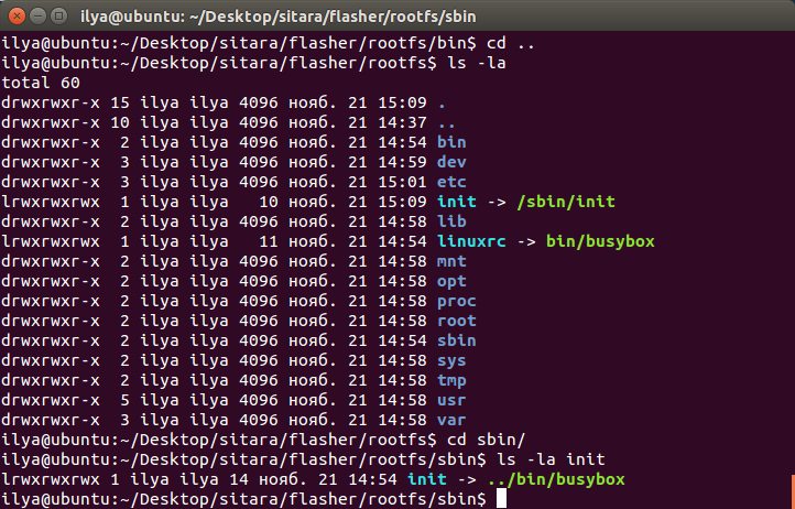

I'm trying to boot Linux in DDR with initfs on my customboard, based on SItara AM5728.
I,ve build busybox and create root file system as it described here. Kernel was configured as it describes here
Firstly, it gives me following error:
[ 2.351314] VFS: Cannot open root device "(null)" or unknown-block(0,0): error -2
[ 2.358879] Please append a correct "root=" boot option; here are the available partitions:
Then I've add a symbolic link "/init" in the rootfs directory on sbin/int . And now, when I'm trying to boot my kernell, new error appears:
[ 2.404646] Failed to execute /init (error -2)
[ 2.409571] Kernel panic - not syncing: No working init found. Try passing init= option to kernel. See Linux Documentation/init.txt for guidance.
What am I doing wrong?
I'm attaching my inittab, rcS files, and bootlog with last error:

[    2.385715] Warning: unable to open an initial console.
[    2.391557] Freeing unused kernel memory: 1460K (c08b1000 - c0a1e000)
[    2.398032] This architecture does not have kernel memory protection.

#!bin/sh
mount -t proc none /proc
mount -t sysfs none /sys
echo /sbin/mdev > /proc/sys/kernel/hotplug
/sbin/mdev -s
#Set PATH
export PATH=/bin:/sbin:/usr/bin:/usr/sbin:/usr/local/bin
