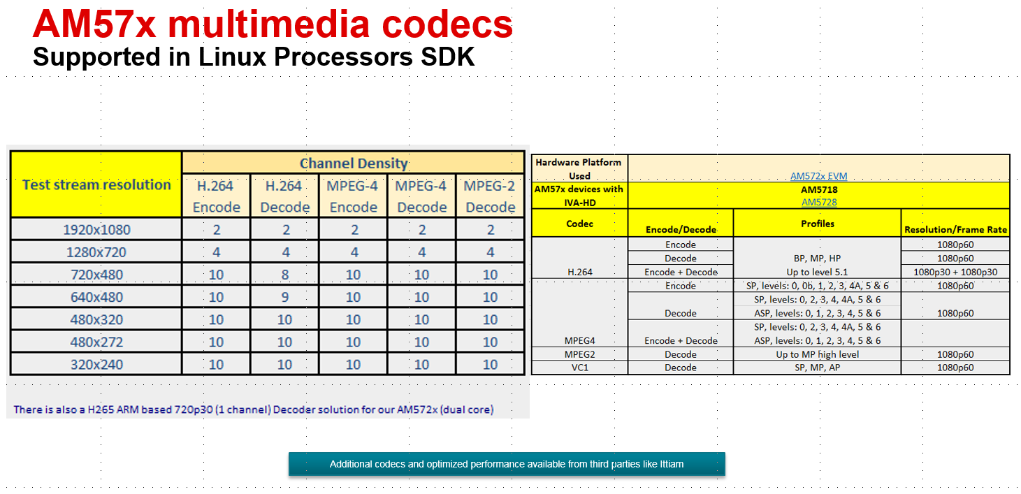

    2.Can we encode/decode H.264 network streams with up to 1080p30? Is any licensing required for H.264 Codec?
    Yes, that's possible. No licensing required for codec binaries available in PSDK. Licensing will be required to get the codec source code.

  • Just updating the codec available
