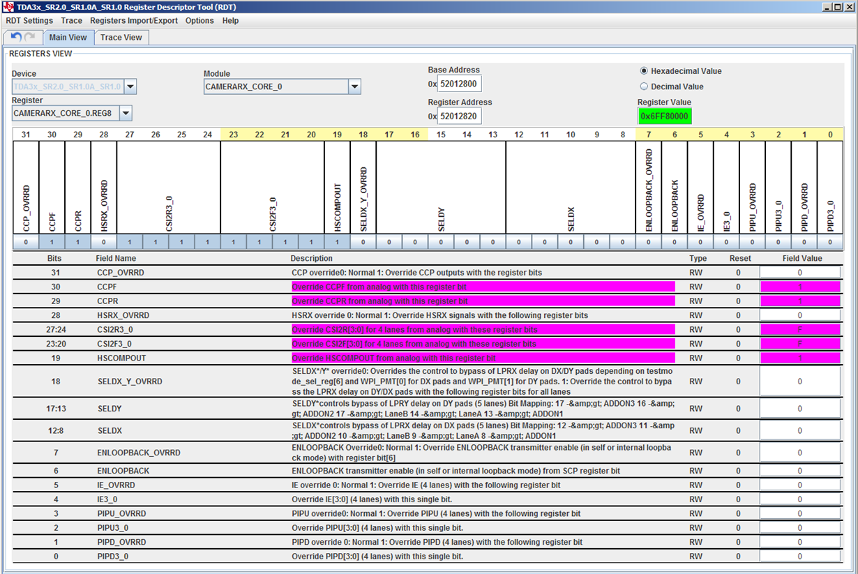

I have a ISP connected to the TDA3X CSI2 interface. The driver seems to work correctly but TDA3X can't get any data from ISP.

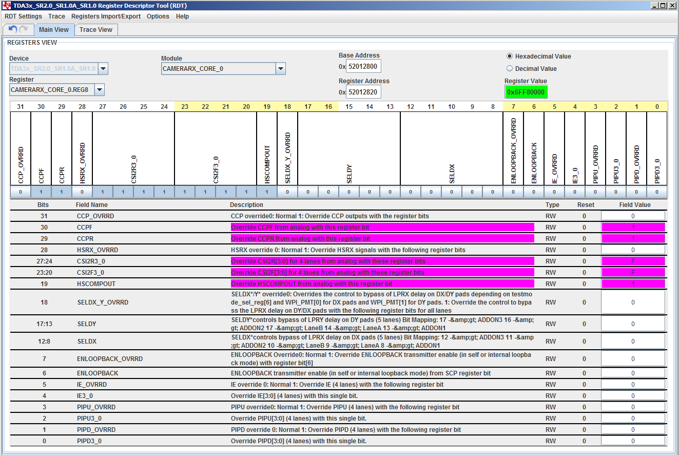

I dump all the PHY register and find the value of REG8 is abnormal. The value is 0x6ff80000. According to the TRM, it indicate CCPF/CCPR/HSRX_OVRRD/CSI2R3_0 are override.
But I don't konw what is meaning.  Can someone tell me what is CCPF/CCPR/HSRX_OVRRD/CSI2R3_0 override?
