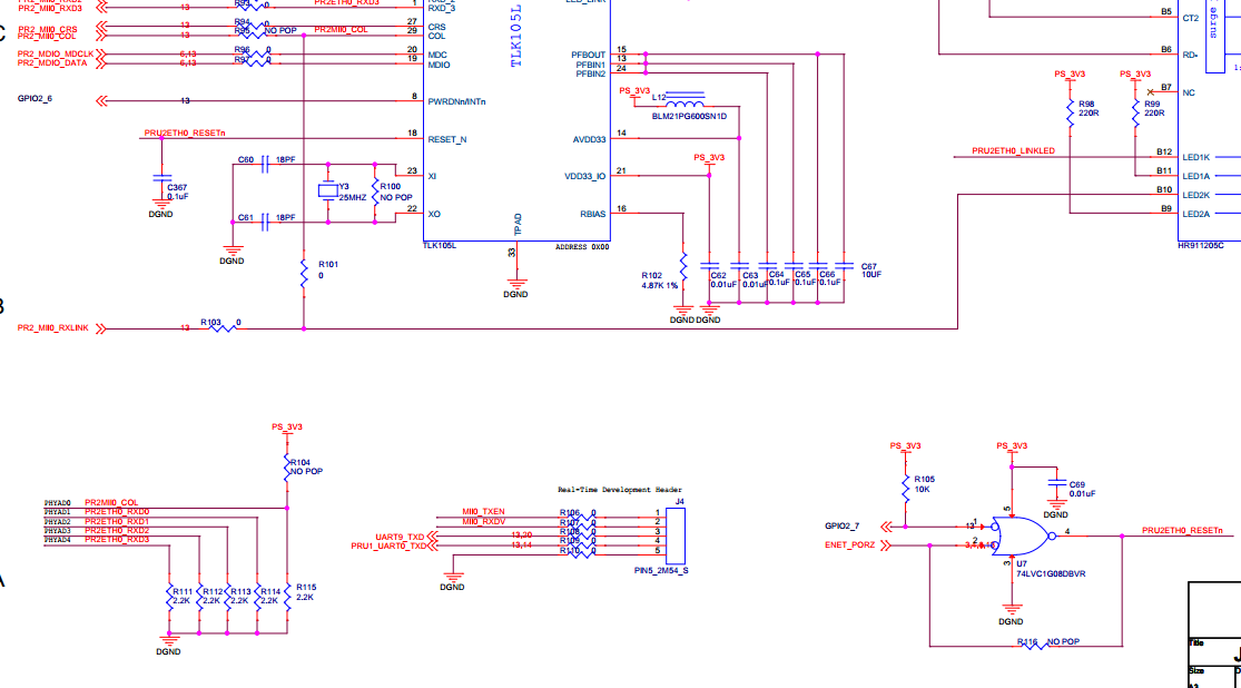

AM57x PRU-ICSS Ethernet network unreachable
Other Parts Discussed in Thread: AM5718, DRA72, DRA722, AM5728, DRA742, TLK105L
our board schematic is reference IDK board.

    Use the oscilloscope to measure the signal:
    RXD [0: 1], RX_DV has the signal
    TXD [0: 3], TX_EN has no signal
    The TX_CLK and RX_CLK clocks are 25MHZ

  • Hi
    The TXD_EN, TX_CLK, RX_CLK, RXD [3: 0] signals are currently being detected using the oscilloscope. but TXD [3: 0] does not detect the signal
    Why ip address or can not be obtained, the network of ping nowhere??
  • Can you confirm that you configured the pin mux correctly for the PRU Ethernet pins? In the example provided in the Linux Processor SDK on the IDK boards this is accomplished during U-Boot. This might explain why you don't see signals on all of the Ethernet pins.
    Check out the '{u-boot directory}/board/ti/am57xx/board.c' and '{u-boot directory}/board/ti/am57xx/mux_data.h' files.
    Jason Reeder

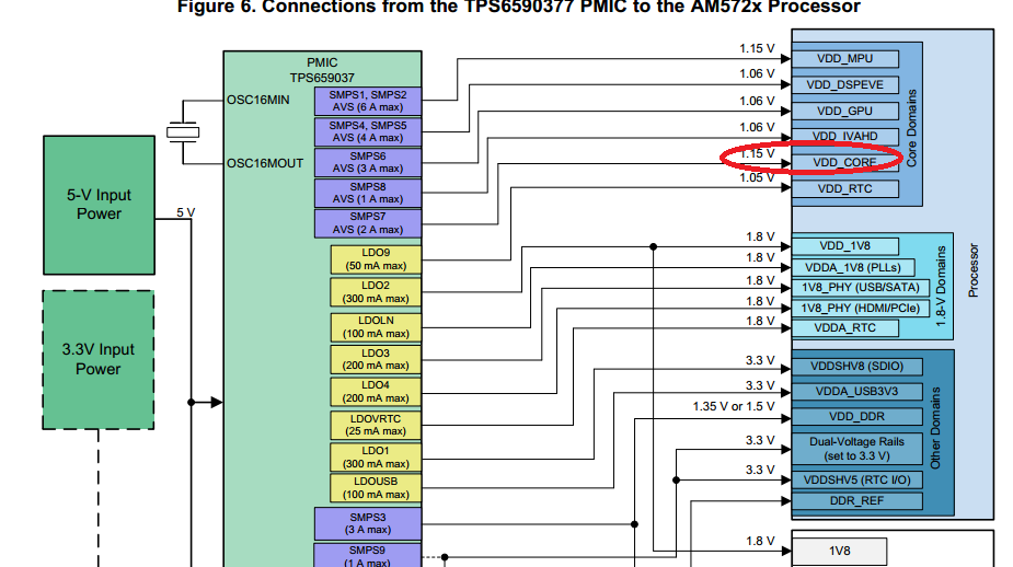

  • HI:
    yes, I am configured the pin mux correctly for the PRU Ethernet pins.
    Our board power management solutions and IDK different, we use beagle's power management program, which will be affected??
  • Can you share your 'pruss2_mdio' pieces of your device tree as well? In the Processor SDK these are spread out across dra7.dtsi, am57xx-idk-common.dtsi, and am572x-idk.dts. I'm mostly interested in making sure that the 'reset-gpios' and 'reset-delay-us' properties are being set correctly (similar to the am572x-idk.dts file).

  • Hi jason
        The following is the schematic diagram of our board, We are not using the network port rj45 We are using HR911205C。the other part of the same IDK schematics
    I am using the kernel and file system provided in v3.0.0.4 of the Linux Processor SDK
    Attachment package contains the device tree source code, pin multiplexing configuration, the schematic diagram
      am728_igh.tar.gz
  • One thing that stands out is that you are boot strapping both of your PRU_ETH PHYs to address 0x01 on the PR2_MDIO bus. Table 5-1 in section 5.1.1 of the TLK105L datasheet (http://www.ti.com/lit/gpn/tlk105l) shows that the COL pin is the boot strap pin for PHYAD0. Both of your COL pins on your TLK105L connections are being set HIGH at reset which would make both of your PHYs respond to MDIO data sent to address 0x01.
    From your labels in your schematic it looks like you wanted to mimic the addressing on the IDK board where PR2_ETH0 is address 0x00 and PR2_ETH1 is address 0x01. See the differences in the COL pin strapping in the IDK schematic (http://www.ti.com/lit/pdf/tidrlh4) on pages 13 and 14. PR2_ETH0 has a 2.2k pull down resistor on the COL line that sets its address as 0x00 where PR2_ETH1 matches your schematic (no pull down) and gets set to address 0x01.
    Let me know if this helps.
    Jason Reeder
  • Hi jason
        As shown in our schematic section, the PR2_ETH0 has a pull-down on the COL pin with the 2.2K resistor set to address 0x00. PR2_ETH1 is the pull-up 2.2K resistor set address 0x01,
       I also made the following changes to ensure that the schematic diagram and IDK consistent:
         1,  Replace the L12 and L13 inductors with 0 ohm resistors  (pin 14)
         2,  the MDIO pull-up 2.2K resistor (pin 19)
         3,  the C367 and C368 capacitor removed (pin 18)
       Where is the PRU_ETH PHYs address set in the software section?
  • HI Jason
    IDK and EVM hardware GU found in the IDK board on the VDD_CORE set voltage is 1.15V, Beagle board VDD_CORE set voltage is 1.06V.This will have an impact on the PRU it?
    http://www.ti.com.cn/tool/cn/tmdxidk5728?keyMatch=AM5728%20IDK&tisearch=Search-CN-Everything
             http://processors.wiki.ti.com/index.php/AM572x_General_Purpose_EVM_HW_User_Guide

  • My mistake, I had missed your pull down resistor on PR2_ETH0. This looks correct.
    My question about the power management was a misunderstanding. We thought you were talking about power management firmware that might be sharing SRAM space with the PRU Ethernet driver. But, it is now clear that you are talking about the Power Management IC on the board.
