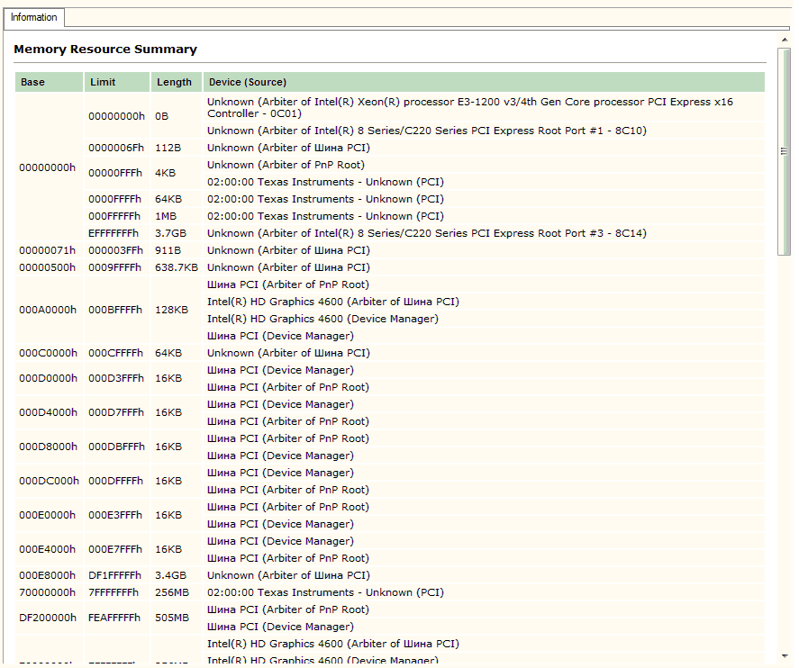

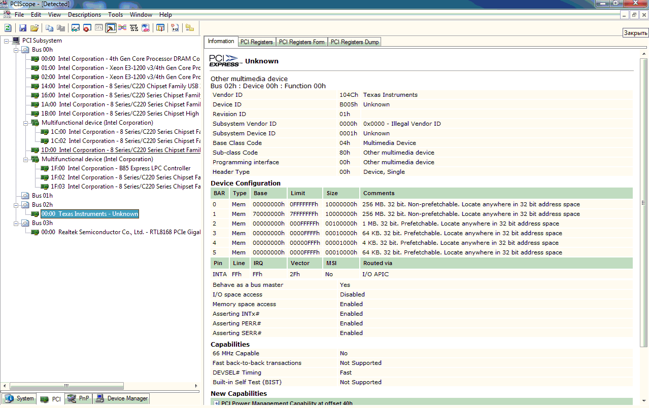

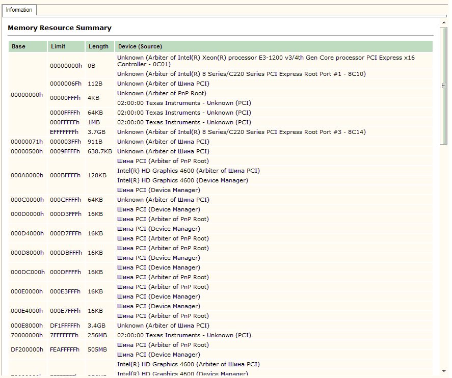

  • I have some changes in situation. I've installed PCIScope and Jungo WinDriver on same host PC. WinDriver shows message while opening evm. It tells that hardware could not be opened, resource overlap. I've checked that  addresses in BARs are out of range of bus 2. I've changed BARs.Now while write/read transactions software shows 0xFFFFFFFF all memory cells, dstbuf is still empty. But now I guess I'm writing in right place but evm does not answer properly.
    You can try to use BAR1 0x7000_0000, this is a 32-bit memory no-prefetchable bar (same as our test between two TI EVMs, EP side). Then check 0x2180_0300 to 0x2180_030c on DSP side how the inbound translation setup. Will any read/write from/to 0x7000_0000 using your host SW reflected on DSP memory (check address on IB_OFFSET0)?
    Regards, Eric
  • I'm already tryed 0x70000000. Software on host PC shows that I have some resource overlap with that default addresses in example. Changing addresses due to PCI to PCI bridge helps to avoid it.
    Also I've got something! I've turned switches to ROM PCIe Boot and after power on PC evm appeared in system and host PC automatically modified BARs due to PCs address ranges and I can write or read some trash to DSP.

    But I've got it in a strange way. I have turned switches which are intended in booting to ROM PCIE Boot positions. After host PC power up I have checked that evm appeared in system with initialized BARs by host PC. Then I have modified PCIe application regs:
    1. Offset 0x310 to 0x1,
    2. Offset 0x314 to BAR1 reg value,
    3. Offset 0x31c to wanted address in DSP memory.
    Also I've turned off caching in platform. BAR1 was configured as prefetched memory by host PC. After all that things done I've got right array in DSP memory after write transactions by host PC.
