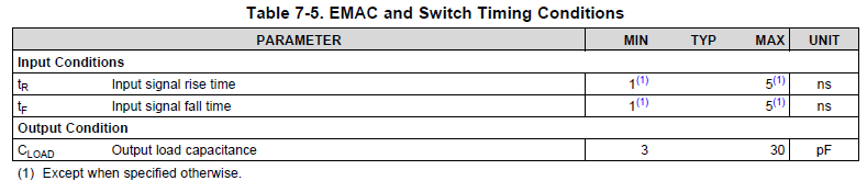

In Am335x Data Sheet,
rise time and fall time is defined, but what transition does they actually mean ?
Seeing this post..
e2e.ti.com/.../448447
James says that input rise/fall times are specified from 10-90% of full input range.
(in AM437x)
Genaral Wikipedia says same thing..
en.wikipedia.org/.../Rise_time
en.wikipedia.org/.../Fall_time
Are they can applied for AM335x's rise/fall time ?
