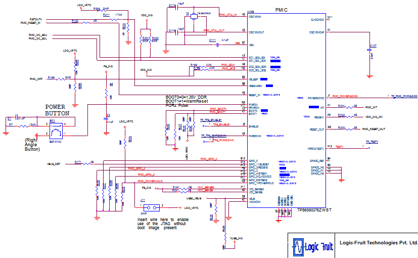

We are using XAM5728AABCXE with PMIC TPS6590376ZWST.
We are using SD Card for booting up.
But since the PMIC is "ON" only for 7 seconds by default, the DSP is not able to boot from SD Card.
All clocks , Voltages and SD Card have been verified.
Boot pin configuration is correct for SD Card.
But when we press the power button at the PWRON pin of PMIC , we get SD Card Clock for very less time ( fraction of second).
Kindly suggest where can be the problem.
