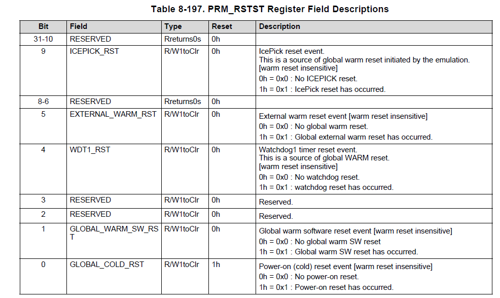

The AM3352 will reset after ESD shock In the ESD test. The ESD shock level is 22KV.
Any interface or GPIO (except PORZ, NRESETIN_OUT&RTC_PORZ)will cause the AM3352 reset after ESD shock?
