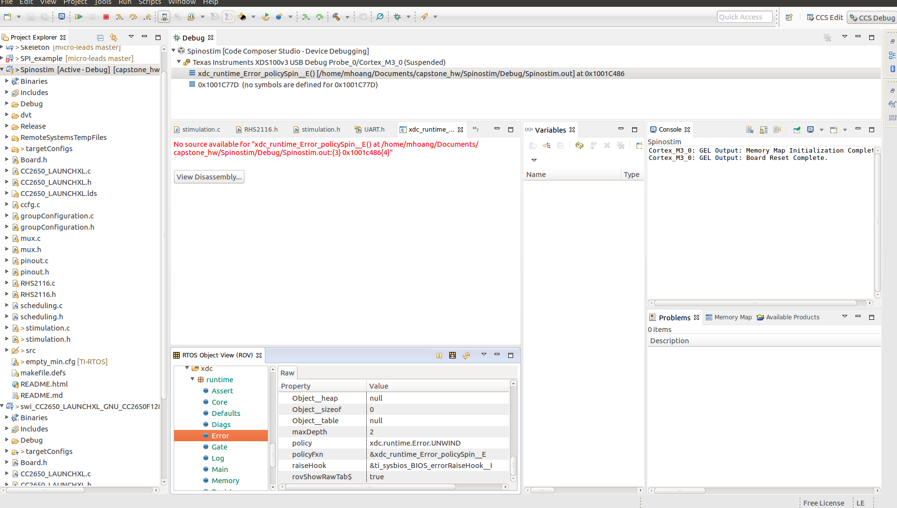

I'm trying to call UART_read() within a callbackFxn registered by Clock_construct(). Calling UART_read() completes the callback function, but then throws a "policySpin" error with the following code:

Not quick sure where to start with this one - commenting out UART_read() does not produce hanging of any kid. What's odd is the hanging only occurs after the callback is exited (i.e. I step though the last line of the callback). I've already enabled "BIOS.libType = BIOS.LibType_Debug;" in my .cfg script in an attempt for proper debug symbols to allow me to step through code with no such luck.
Ultimately, I'm trying to poll a UART handle periodically. I have several clock functions that are all time sensitive (micro-second granularity) and am trying to poll uart with the least amount of latency possible. This means avoiding for/while loops or using large receive buffers and this clock function is in charge of polling UART. If possible, I'd like to keep it within a Clock_construct() function as all of the clock functions are chained together. I've already tried closing my previous UART session and opening a UART session within this clock function without calling UART_read(). The same error is produced.

    I see two problems:
    1. You should not use a blocking call (your UART_read) from a Swi (you clock callback). It might take a long time and block other tasks.
    2. The definition of the function pointer that you pass to clock construct takes only 1 argument Below is the definition of the function pointer that is expected:
    typedef Void (*Clock_FuncPtr)(UArg);
    I would recommend that you use polling from within a task. It will unblock after the "delay" and therefore offer a form of synchronism.
    Alternatively, if you must use the clock to synchonize your tasks, you can use UART_MODE_CALLBACK (refer to documentation for more info). When using the callback mode, read only 1 character at a time. In your callback, you could store the character, and your clock callback would only check if any new characters have arrived.
