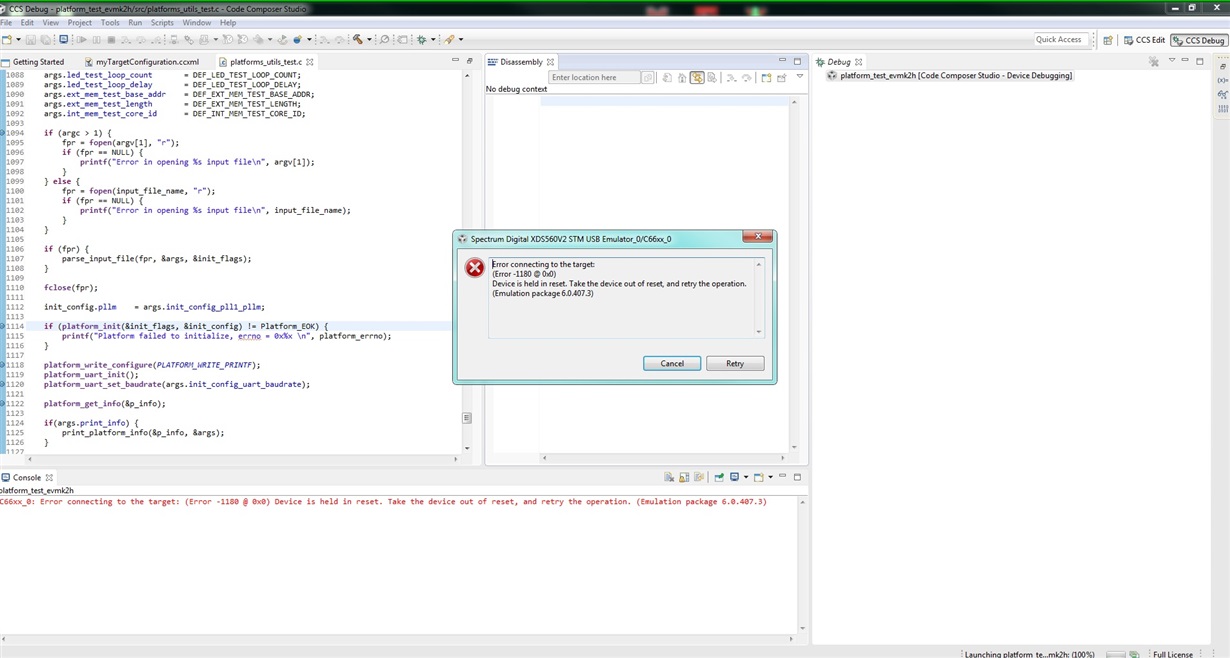

Hello, I am having trouble connecting to the TI ARM+DSP processor on the EVMK2H board. I am using a XDS560v2 STM USB emulator. I am able to use the SD560v2Cnfg utility and it successfully is able to find a Emulator. I am trying to run the "platform_test_evmk2h" project. I have setup the Target Configuration and ran the Test Connection Toot. Here is its output:
[Start: Spectrum Digital XDS560V2 STM USB Emulator_0]

I have the boot DIP Setting to 0010.
When I try to run the platform_test_evmk2h project I get the following reset error message:
If I change the boot DIP setting to 0001 I don't get this error message, BUT the program hangs at line 1114 platform_init().
Here is my project zipped up:
platform_test_evmk2h.zip
I have left the DIP setting to 0010 and tried removing the XCS200 but I get the same runtime error message about the processor in reset. The LCD on the board does say that it completing booting.
I am using the gel file "xtcievmk2x.gel" one DSP core 0.
Any ideas?

  • Joe,
    Whenever you are loading code over the emulator, we recommend that you set the EVM in No boot/Sleep Boot mode. whe you set the EVM to any other boot mode for example UART/SPI/NAND boot, the BOOT ROM initializes the device clocks and PSC which will interfere with your setup. Also, note that the EVM ships with Linux boot images (u-boot, linux kernel and Filesystem flashed on the NAND) so when you set the DIP switch to NAND boot, the Linux boot images will boot up and may put the DSP core in reset.
    processors.wiki.ti.com/.../EVMK2H_Hardware_Setup
    One way to check for this is to connect to the SOC UART/ BMC UART(FTDI USB port on EVM) using a mini USB cable and check the logs observed on the UART terminal. On the Host you can setup a serial terminal like Hyperterminal or Terterm and set the baudrate to 115.2kbps. When you boot in No boot mode, you should see no logs on the SOC serial terminal
    Rahul
    PS: If you are using Rev4 EVM then check if the boot mode is being displayed on the LCD and BOOT SUCCESS message as there is a power management issue due to the UCD firmware that can be fixed by updating the firmware.
  • Hello and thanks for helping me. I changed the DIP to No Boot mode and when I run the platform_test the program hangs at the platform_init() function. Here is the error:
    Here is my gel file config:
    Here is the text while I switch to Debug mode:

    C66xx_0: GEL Output: Set_PSC_State... Timeout Error #03 pd=24, md=42!
    C66xx_0: GEL Output: Set_PSC_State... Timeout Error #03 pd=25, md=43!
    C66xx_0: GEL Output: Set_PSC_State... Timeout Error #03 pd=25, md=44!
    C66xx_0: GEL Output: Set_PSC_State... Timeout Error #03 pd=25, md=45!
    C66xx_0: GEL Output: Set_PSC_State... Timeout Error #03 pd=25, md=46!
    C66xx_0: GEL Output: Set_PSC_State... Timeout Error #03 pd=26, md=47!
    C66xx_0: GEL Output: Set_PSC_State... Timeout Error #03 pd=27, md=48!
    C66xx_0: GEL Output: Power on all PSC modules and DSP domains... Done.
    C66xx_0: GEL Output: WARNING: SYSCLK is the input to the PA PLL.
    C66xx_0: GEL Output: Completed PA PLL Setup
    C66xx_0: GEL Output: PAPLLCTL0 - before: 0x0x098804C0	 after: 0x0x09080500
    C66xx_0: GEL Output: PAPLLCTL1 - before: 0x0x00000040	 after: 0x0x00002040
    C66xx_0: GEL Output: DDR begin
    C66xx_0: GEL Output: XMC setup complete.
    C66xx_0: GEL Output: DDR3 PLL (PLL2) Setup ...
    C66xx_0: GEL Output: DDR3 PLL Setup complete, DDR3A clock now running at 666 MHz.
    C66xx_0: GEL Output: DDR3A initialization complete
    C66xx_0: GEL Output: DDR3 PLL Setup ...
    C66xx_0: GEL Output: DDR3 PLL Setup complete, DDR3B clock now running at 800MHz.
    C66xx_0: GEL Output: DDR3B initialization complete
    C66xx_0: GEL Output: DDR done

  • Joe,
    Your GEL output looks fine now. You can ignore the PSC timeout errors as they seem to be occuring from modules that are not enabled on this chip. The code seems to be hanging in the Serdes intialization and I am not sure if there is some additional step needed to resolve this issue. Let me try to reproduce this and also loop in a colleague who is more familiar with the Serdes initialization.
    Rahul
  • Joe,
    When you had the build error in a previous post, I discussed with our development team. The platform_test is obsolete, sorry for this. The suggested board test is using the board diagnostic processors.wiki.ti.com/.../Processor_SDK_RTOS_DIAG
    For K2H device, it is POST processors.wiki.ti.com/.../Processor_SDK_RTOS_POST
    Can you try if POST works for you? See the post.c:
    init_flags.phy = 0;
    acc_fail = 0;
    Another way to use platform_test is to set init_flags.phy = 0 before calling platform_init() to bypassing this serdes issue.
    Regards, Eric
