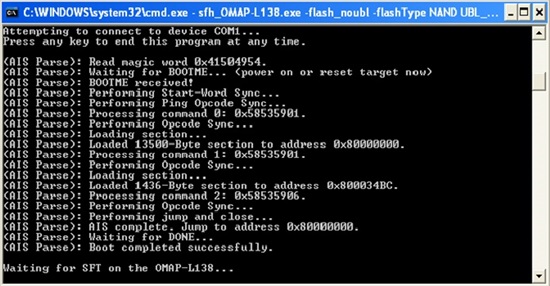

    thanks for all your replies for my query. Finally i want to ask  some solution regarding the Sfh utility. As i mentioned in the above post our board is using a DDR2 chip(MT47H128M16RT) and a NAND with 1.8v (MT29F4G08ABBDAHC-IT) than EVM; so when i use the sfh utility the command line will stuck with the line
    ""Waiting for sft.....""
    so i believe in a change of  sfh utility to my custom board. But i am confused with the entire package structure of OMAP-L138_FlashAndBootUtils_2_29  to generate sfh_OMAP-L138.exe. Can you suggest any possible change i have to make in the package for rebuilding?The rts lib problems are now resolved and rebuilding is successful.
    Thank you

  • Hi
    Its a useful link for me . after proper changes in device.c whether i should run make command from GNU directory or OMAP-L138 dir. while running make command in OMAPL138  will take  time at CCS project  rebuild.
  • Hi Mukul
    To be specific
    i had done all the changes to custom board but booting through the sfh will end with the massage "Waiting for SFT on the OMAP-L138..". Do you have any ideas to troubleshoot the problem
  • Do you have CCS, and if so connect to see if the DDR is working by checking the 0xc0000000 memory region in the memory window.
    Also try doing -v to see if it gives more info on the failure.
    Jeff
