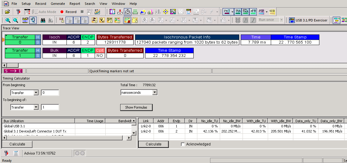

We are getting 60 Mbps bandwidth for AM5728 as an USB-UVC device (instead of 150 Mbps) . Please see following observations. Please let us know the USB configuration and solution.
Observations/tests:
1. AM5728 USB 2.0 Device (UVC)
         -- We are getting only 60 Mbps.
         -- We noticed the HW is just doing one transaction of 1 Kbytes  every 125 microsecond.
             We tried to configure for three transactions and noticed that it is still sending one packet only and drops other two.

    "-- We noticed the HW is just doing one transaction of 1 Kbytes every 125 microsecond. "
    If the customer tests under Linux, this is expected, please note that the current kernel doesn't support high-bandwidth Isoch transfer yet. The community is working on getting the patches merged into next kernel v4.10.
    If you can let me know what kernel version the customer uses, I can try provide those patches for that kernel.

  • Bernd,
    The Linux kernel doesn't support high-bandwidth Isoch transfers in uvc gadget driver (g_webcam) yet, the community is working on it.
    The patches attached below enable high-bandwidth Isoch transfer on AM572x, but it is for evaluation only, since it is work-in-progress. (With these patches on TI 2016.05 I have to reboot the board after streamed the video once.)

    Does it take care of  high bandwidth configuration? (three transactions per isoc)
    Chandra
  • Chandra,
    Yes, it does so with patch 0001 and 0002 already. The update adds the fix to the issue that the test can only run once.
    The high-bandwidth runs fine, I see three transactions per SoF on the USB bus trace. It is just that the host luvcview application doesn't show the video as in the none high-bandwidth case. I guess it is the video format issue in uvc-gadget.c or luvcview. I believe our dev team is looking at it. And I don't think it is an big issue if the problem is in uvc-gadget.c (as long as kernel can transmit 3 transactions per SoF), since it is just an example code, and you would have to develop you own application.
  • We applied the patch and running the gadget application.
    We are getting black screen on luvc and VLC player(PC side).
    Please let us know your test setup.
    Chandra
  • Just one more information. for above post.
    We see black screen issue once we enable high bandwidth. (three packets per isoch)

    We have received the prebuilt SD Card image and could not get bandwidth higher than 61 Mbps. Could you check with app engineer to see problem again? We are quite urgent on USB2.0 issue.
    Can you please check.
    Bernd
  • Bernd,
    How the bandwidth is measured? 61Mbps sounds like high-bandwidth not enabled, what is the command line to load g_webcam.ko? Does the customer checked if there are 3 packets per SOF using USB bus analyzer?
    The usb traffic should be 3062 bytes per SOF, so it is about 196Mbps (3062bytes * 8SOF * 1000ms * 8bits).

  • I agree with you that we do not need 1080p MJPEG to test bandwidth. We have used suggested format and found it chokes at 61 Mbps. Unfortunately, Our requirement is 1080p MJPEG. Can you confirm by checking USB traffic that it is capable of at least 150 Mbps at your end in your test setup?
  • Yes, luvcview reports 53fps when streaming_maxpacket=3062, which is about 195Mbps (53fps*640*360*2*8).
    Following is the screenshot of the USB bus analyzer which also shows the USB bus bandwidth is 197Mbps for a 5-secs capture.
  • Are you using USB 3.0 port?
  • No, usb2.0.
