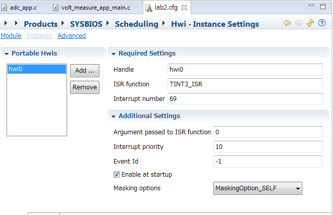

Hi, Everyone
I have a question about Hwi of SYS/BIOS
Can you tell me what is MaskingOptioin_BITMASK in Masking option ?
I do not see this in SYS/BIOS users guide.
Actually I want to know other MaskingOptioin_xxx if you have.
Can you tell me document and Wiki page about MaskingOptioin_xxx ?
Best Regards
    An interrupt mask is a bit mask that tells which interrupts to process and which ones to "ignore". So the masking options will tell which interrupts need to be masked.
    In order to give you a proper answer, we need to know which device you are using. The options available are the ones that you have in the drop-down box (in your screenshot). Here's a link to a thread that shows other options:
    For example, MaskingOption_SELF means that it will mask only itself.
    I am not familiar enough to give you that information, but I'm sure someone from TI will be able to direct you properly to documentation.
  • There is some cdoc documentation that gives this information.
    Depending on what your device is....if you look under the following directory:
    <BIOS_INSTALL_DIR>/docs/cdoc/ti/sysbios/family/
    Now search for the Hwi.html file that your device is using. This should contain some information about the Hwi_MaskingOption_XXX
    Judah

    Thank you for your reply.
    I got it,
