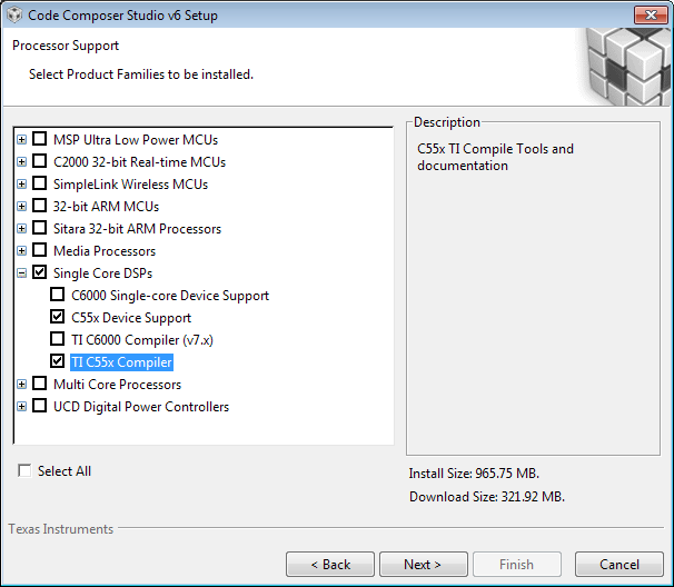

    user4363042 said:
    1. what`s the suggestion debug device for TMS320C5535? xds 560 is too expensive;can your give me a cheap solution?
    The C5535 eZdsp has a built-in XDS100 emulator/debugger - when you plug in the J2 USB port then you can use the embedded XDS100 to connect to the C5535 DSP.
    user4363042 said:
    2.l have download the new version ccs;but l can`t find the c5000 example application code? the spec indicate the old version ccs path; so l cann`t now;
    If you downloaded CCS6.x, then when you run the installer just make sure to check the C5000 box to install the C55x compiler and emulator support.
    Also check the box for Spectrum Digital Emulators on the next window:
    I believe you can re-run the installer with the same install directory after CCS is already installed to install these pieces.
    Once completed you need to find the C55x software...
    I believe the only example code for C55xx that gets installed with CCS is DSP/BIOS (RTOS) examples.
