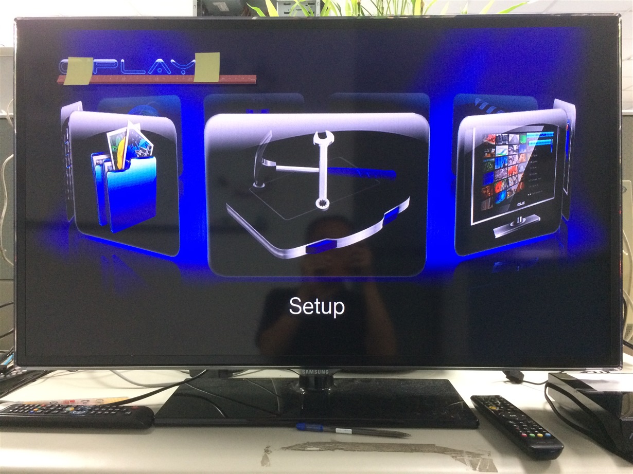

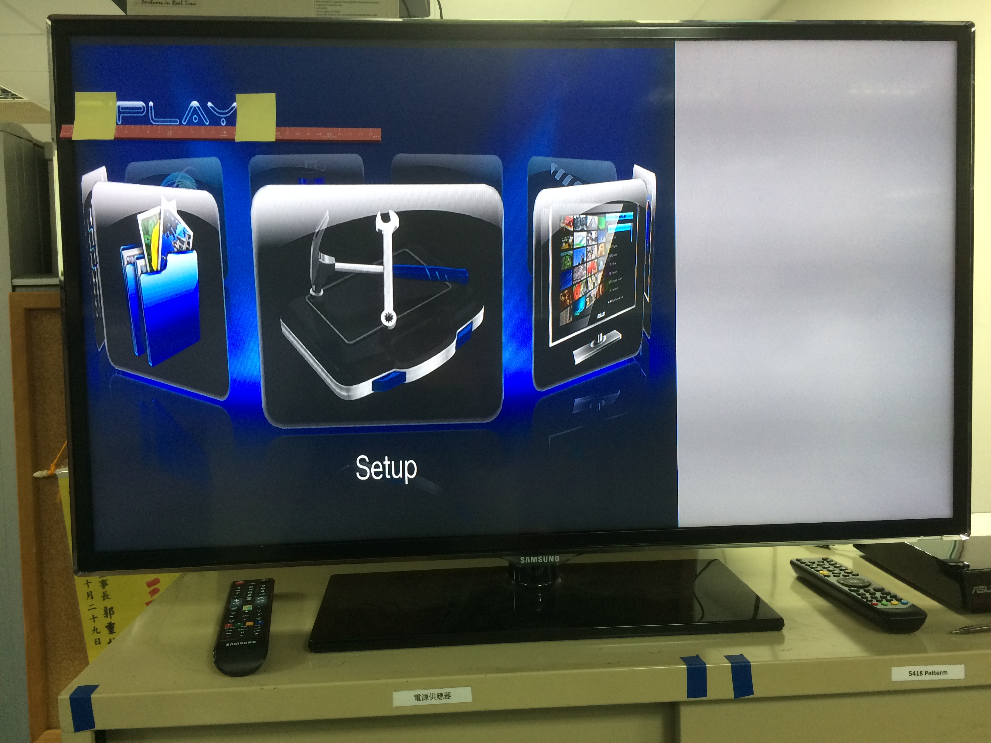

To evaluate DM814x and DVR RDK, we plan to use the following listed hardware & software to capture 1080p60 resolution.
hardware: DM814x Evaluation Module, Expansion I/O board, rev D
software: dvr rdk 04.01.00.02
video source: 1080p60 YPbPr
The very first test program, a capture directly connects to a display, emulates previous posts in E2E community. (for example:
e2e.ti.com/.../261455)
The video seems scaled down horizontally and shifted a little bit vertically. (The attached picture "bad.JPG" was the HDMI output image from DM814x EVM, showing captured video from TVP7002. As a comparison,"normal.JPG" was a component video source connected to TV, showing what video originally should be.) Nevertheless, nowhere in the code seems relating to scaling.
normal.JPG:
bad.JPG:
We also tried to capture 720P60 with the very same code, except the fixed video standard was changed to 720P60. The video seemed normal, NOT scaled.
Later on, we thought software mosaic might be a key element to put the display to a proper windows position from (0,0) to (1920,1080). But the result was disappointing.
What we have done so far:
1. As other posts on E2E forum suggested, we added a capture device TVP7002. It works.
2. Following the flow of MCFW demo program, we added a case to do only capture--display. (and later capture--swms--display)

    First, can you please check if the scalar is enabled in the capture link? If it is enabled, you might be downscaling the image to 720p and then displaying it on 1080p display. Which is why you are getting downscaled image at the offset 0x0 on the display.
    Please disable scalar in the vip. There is some scBypass flag set to FALSE, to enable scalar. Set it to true and set the output frame size to 1920x1080. it should work then.

    In your usecase file, can you please set numSwMs variable to 0? This will make sure that the capture is directly connected to the display?
    Also it looks like scalar is enabled in the VIP path. bit2 at the offset 0x5800 is set to 0, so scalar is enabled in the path. can you please make sure that the scalar is disabled by setting scEnable flag to FALSE?

    I see abnormal numbers out of VIP Parser. Log shows height=1080, which is alright; but width=1276, not 1920.
    I have no clue what could ever cause this width.

  • Can you tell me the value at the location?
    0x48105530/0x48105A30/0x481055C0/0x481055C0/0x48105AC0/0x48105AC0?
    It looks like capture itself is getting 1276x1080 frame size. so want to check if cropping is enabled in VIP? or VIP itself is getting smaller frame size from decoder.
    Which decoder device are you using for 1080p frame size? Do you know how it is connected to VIP?

  • Hi Brijesh,
    The values at the locations:
    reg 0x48105530 = 0x04FC0447 // 1276x1080 as we saw yesterday
    reg 0x48105A30 = 0x0
    reg 0x481055C0 = 0x0
    reg 0x48105AC0 = 0x0
    We are using TVP7002 on EXPANSION I/O BOARD REV D with DM8148 EVM. We are using 16bit YCbCr 422.
