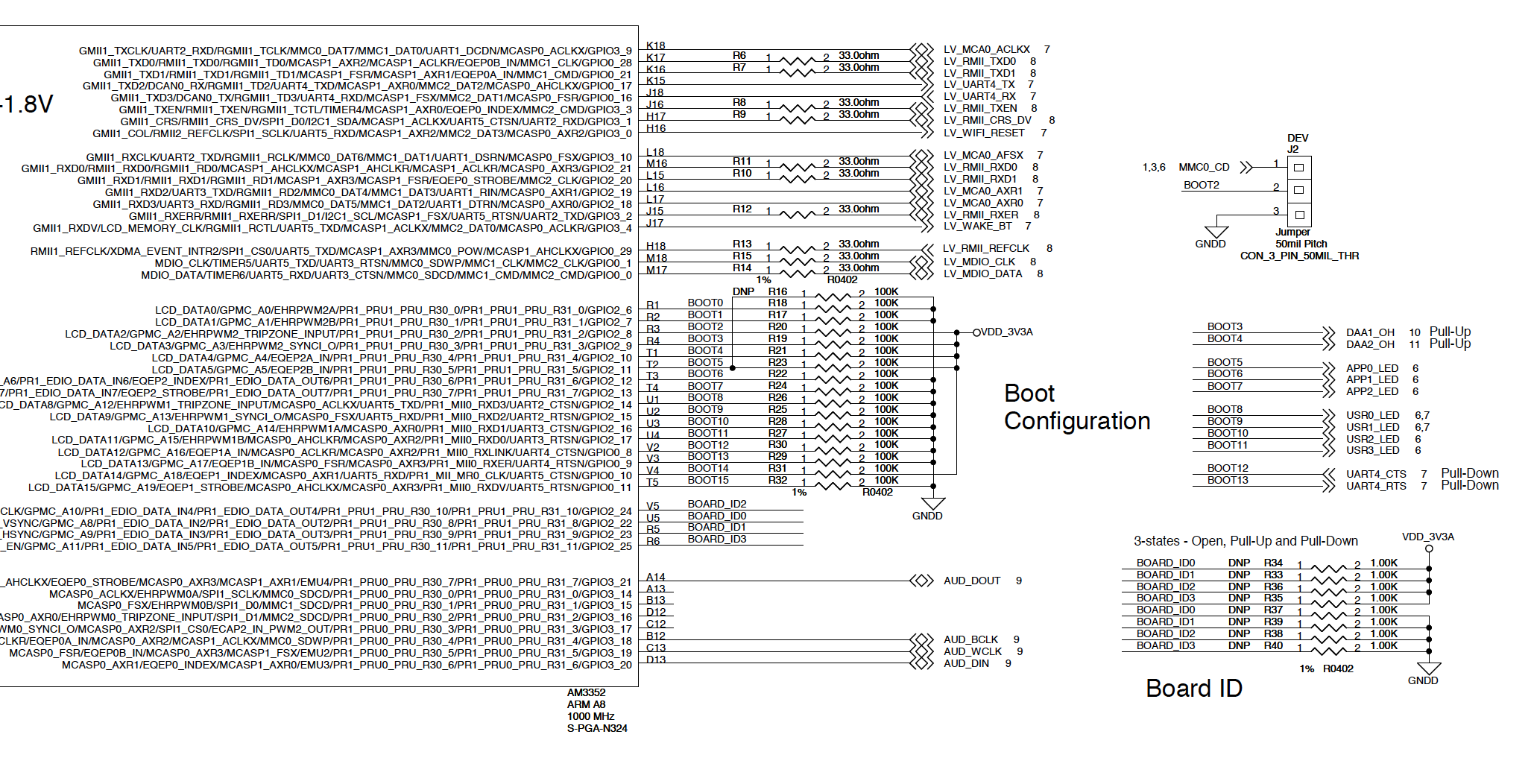

  • Can you post the SYSBOOT section of your schematic?
  • Hi Biser,
    Thanks for helping.
    Here is the SYSBOOT section of our schematic...
    Best
    R
  • One thing to check - some of your SYSBOOT signals are connected to external circuitry as well. Please check that all of these are at the required levels at reset release time.
  • Hi Biser,
    Thanks.
    The BOOT3 and BOOT4 pins are outputs & connected to input pins DAA1_OH & DAA2_OH on the other side. So I am assuming that should be OK?

  • What about the BOOT12 and BOOT13 signals? If these are OK too, I cannot say what's happening without having the entire schematics.
  • Hi Biser
    Both BOOT12 and BOOT13 stay at Ground throughout the boot process. After booting up I see that they can go high.

  • Something does not seem right to me around the N_RESET signal. Can you try to modify this on a single board to be exactly like the BBB?
