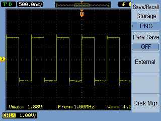

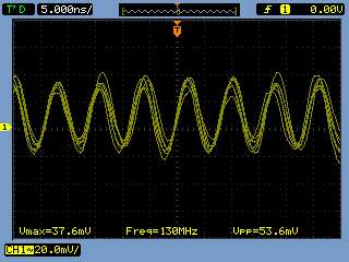

     We are using AM3352 ZCZ Package with Marvell 88E1512 PHY device in our customised board.We have made RGMII configuration as in AM335x starter kit.While testing Link is UP.Ping is not happening.No activity on the wireshark.While debugging found that RGMII TX_ClK is not coming but RX_Clk from PHY is coming.The console log is shown below.

# ifconfig eth0 10.3.3.15 up
[   22.280578] net eth0: CPSW phy found : id is : 0x1410dd1
# [   34.273376] Trying 1000/FULL
[   35.272796] PHY: 0:00 - Link is Up - 1000/Full
# ping 10.3.3.17

  • It seems to me that your scope probe and/or frequency range is not good enough.
          With same probe and oscilloscope we checked rxclk and mdio clock and its coming fine.Below are the pics.
    Rxclk ...
    MDIO_CLK ...
