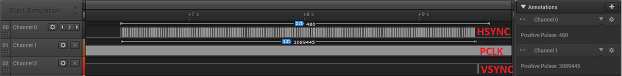

I'm having trouble interfacing a custom camera board I've been working on for the AM572x platform. The camera board is build around a OV5640 sensor and we are using 8-bit DVP interface for data output.
We are running linux kernel 4.4.46 on the module and I've been working on a v4l2 driver in order to interface the camera to the board. I've successfully managed to get the camera driver to detect and bind to the VIP3A port as well as  the camera itself.
The trouble I'm experiencing is getting an sensible image output from the camera as for what is expected. I'm outputting a standard color bar test image from the camera in YUV422 format (YUYV) , and I'm able to capture complete frames using the qv4l2 tool. However my output seen below is far from what is expected, and are independent on the bit order (reversing the output order from the camera does not affect the image itself).
The VSYNC, HSYNC and PCLK signals is working as they should (as far as I'm aware), a sample of the using a logic analyser can be seen below.
At this point I've been stuck for some time now, being unable to get any proper output from the camera. I've crosschecked the camera setting with numerus other sources and they check out, also there is data present on all data lines. My thought is that I must have missed something in either the driver or how to properly use the the VIP port for this purpose as I'm very new to this field.  The driver I'm running is a brew of a old ov5640 v4l2 driver that I've tried to port for the AM572x using the existing TI mt9t11x driver.

In my board file I've added the following entries, and as far as I can see the V4L2 interface sets the correct polarity for the V- and HSYNC:
&i2c5 {
	status = "okay";
	clock-frequency = <100000>;
	ov5640@3c {
	        compatible = "ti,ov5640";
		reg = <0x3C>;
		gpio-reset = <&gpio2 5 GPIO_ACTIVE_HIGH>;
		gpio-pwdn = <&gpio2 6 GPIO_ACTIVE_LOW>;
		port {
			cam: endpoint {
			     	remote-endpoint = <&vin3a>;
				hsync-active = <1>;
				vsync-active = <1>;
				pclk-sample = <0>;
				input-clock-freq = <24000000>;
				pixel-clock-freq = <1000000>;
&vip2 {
	status = "okay";
&vin3a {
	status = "okay";
	endpoint {
		slave-mode;
		remote-endpoint = <&cam>;
In the dmesg i can find the following entries:
[   10.776107] vip 48990000.vip: loading firmware vpdma-1b8.bin
[   10.783949] vpe 489d0000.vpe: loading firmware vpdma-1b8.bin
[   10.809461] vip 48990000.vip: VPDMA firmware loaded
[   10.809769] vpe 489d0000.vpe: Device registered as /dev/video0
When loading the ov5640 module:
[  724.026646] ov5640 4-003c: input-clock-freq: 24000000
[  724.026660] ov5640 4-003c: pixel-clock-freq: 1000000
[  724.026669] ov5640 4-003c: Bus_type: V4L2_MBUS_PARALLEL 0
[  724.026676] ov5640 4-003c: Bus_flags: 405
[  724.026688] vip2-s0: Port A: Using subdev ov5640 for capture
[  724.036446] vip2-s0: device registered as video1
[  724.053140] ov5640 4-003c: Detected a OV5640 chip, revision 0
[  724.063767] ov5640 4-003c: Sensor ID: 5640
[  724.125095] ov5640 4-003c: Init extra controls
[  724.125135] ov5640 4-003c: ov5640 sensor driver registered !!
Checking the device with v4l2-ctl i get thw following:
root:~# v4l2-ctl --all --device=1
Driver Info (not using libv4l2):
Driver name : vip
Card type : vip
Bus info : platform:vip
Driver version: 4.4.36
Capabilities : 0x85200001
Video Capture
Read/Write
Streaming
Extended Pix Format
Device Capabilities
Device Caps : 0x05200001
Video Capture
Read/Write
Streaming
Extended Pix Format
Priority: 2
Video input : 0 (camera 1: ok)
Video Standard = 0x00ffb0ff
PAL-B/B1/G/H/I/D/D1/K
NTSC-M/M-JP/M-KR
SECAM-B/D/G/H/K/K1/L/Lc
Format Video Capture:
Width/Height : 640/480
Pixel Format : 'YUYV'
Field : None
Bytes per Line: 1280
Size Image : 614400
Colorspace : Broadcast NTSC/PAL (SMPTE170M/ITU601)
Flags :
Crop Capability Video Capture:
Bounds : Left 0, Top 0, Width 640, Height 480
Default : Left 0, Top 0, Width 640, Height 480
Pixel Aspect: 1/1
Crop Capability Video Output:
Pixel Aspect: 1/1
Crop: Left 0, Top 0, Width 640, Height 480
Selection: crop, Left 0, Top 0, Width 640, Height 480
Selection: crop_default, Left 0, Top 0, Width 640, Height 480
Selection: crop_bounds, Left 0, Top 0, Width 640, Height 480
Selection: compose, Left 0, Top 0, Width 640, Height 480
Selection: compose_default, Left 0, Top 0, Width 640, Height 480
Selection: compose_bounds, Left 0, Top 0, Width 640, Height 480
Streaming Parameters Video Capture:
Capabilities : timeperframe
Frames per second: 30.000 (30/1)
Read buffers : 4
User Controls
mute (bool) : default=0 value=0
loudness (bool) : default=0 value=0
white_balance_automatic (bool) : default=0 value=0
horizontal_flip (bool) : default=0 value=0
vertical_flip (bool) : default=0 value=0
hue_automatic (bool) : default=0 value=0
Image Processing Controls
pixel_rate (int64) : min=0 max=0 step=1 default=0 value=0 flags=read-only
The user controls is a hack used to change the camera signal polarity and bitorder in runtime for debugging. As far as I've been able to see, the polarity of the signals have minor impact on the result, and I'm able to verify the signals polarity change using a oscillocope.
At this point I'm hoping that you might could shed some light on if there is anything I've missed that need to be done on the AM572x side of the project in order to use a custom camera. If you need anymore information tell me what you need and I'll provide it!
Best Regards
Max
