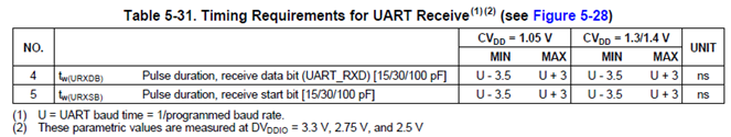

TMS320C5505: Requesting further details related to UART receive timing parameters
Part Number: TMS320C5505
Hello, the C5505 datasheet references the timing parameters below. For tw(URXDB) and tw(URXSB), is this representative of consecutive bit to bit variation, or is it device to device variation? Just trying to determine if consecutive bits on a received byte on a single device would be the same width (both logic level high and low), or if their perceived width could vary as shown in the table below.
