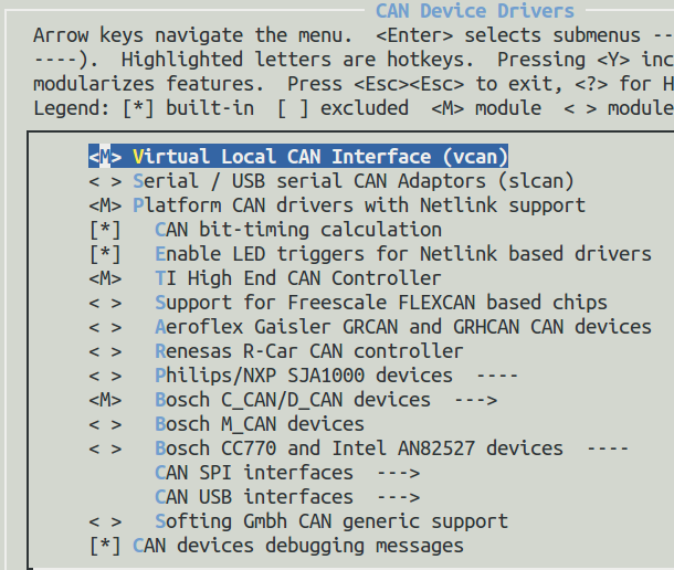

I am having some problems debugging DCAN on AM5728.
Actually i am using
Chip : AM5728
Sdk : ti-processor-sdk-linux-am57xx-evm-03.00.00.04
Board : custom board
Software : linux-4.4.12
Driver : SDK comes with
Kernel configuration :
I run these commands on the board when the print is as follows:
root@am57xx-evm:~# canconfig can0 bitrate 50000 ctrlmode triple-sampling on
can0 bitrate: 50000, sample-point: 0.875
can0 ctrlmode: loopback[OFF], listen-only[OFF], tripple-sampling[ON],one-shot[OFF], berr-reporting[OFF]

I refer to this document: http://processors.wiki.ti.com/index.php/Linux_Core_DCAN_User's_Guide
This is described in the documentation: If the CAN bus is not properly connected or some hardware issues DCAN has the intelligence to generate an Error interrupt and corresponding error details on hardware registers.
So these problems should be how to solve it?
I hope to give some help or advice.
