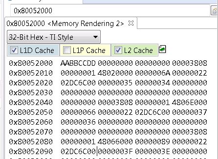

  • Ok, I have managed to get pass this "crash" by converting the Physical address to a virtual address.
    I have a resource file defining the L4_CFG physical and virtual addresses (based on the IPC examples). So, once I converted all access to 0x4A00_0000 addresses to 0x6A00_0000 addresses using Resource_physToVirt the clock got configured correctly.
    However, it now crashes / hangs in the Pcie_setInterfaceMode.
    I have added the different memory section for PCIe in my custom resource table already but that doesn't seem to help. Do I need to do something else?
    As a reference, here is my custom table:

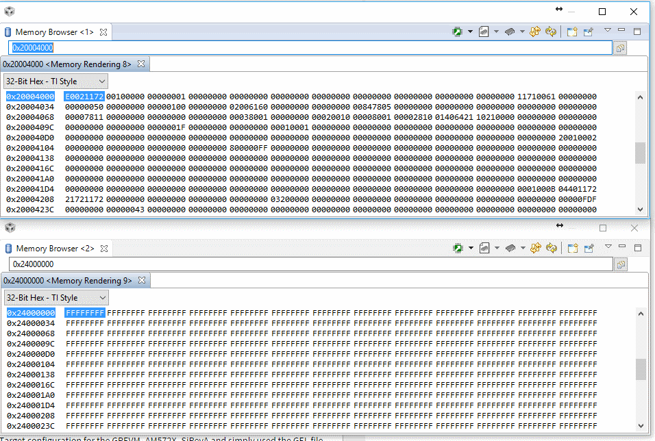

  • It's the M4 that is complaining. I get these traces in the remoteproc trace buffer. I get that when running Linux on the A15 with the PCIe+IPC app running on the M4. I am not able to access any of the FPGA registers. What I am reading in the 0x20000000 space is all gibberish.
    By comparison, when I run a standalone M4, I can properly read the FPGA Vendor and device ID register at address 0x20004000. Reads to higher address return 0xFFFF which is expected since there is only 1 PCIe.
    I haven't tried data access since I need to configure the FPGA BARs from the RC (M4 in this case).
    - David

  • What you are seeing makes perfect sense. Especially after reading the TRM.
    But that is not what I am seeing in the standalone application. When I read @ 0x2400_1000 (using the memory browser of CCS), I get all FFFF with the stand-alone application.
    What GEL file are you using to initialize the M4? I created a Target configuration for the GPEVM_AM572X_SiRevA and simply used the GEL file provided. They don't seem to changed the PCIe mapping to 0x2400_0000.
    This seems like a mapping issue but I don't really know how to fix it. I find it odd that you are seeing the mapping to be @ address 2400_0000 where I see 2000_0000 for the configuration in the standalone app. I've created the example directly from the PDK using the pdkCreateExample. I pratically only changed the Board type from ipkAM572x to evmAM572x in the SYS/BIOS configuration file.
     - David

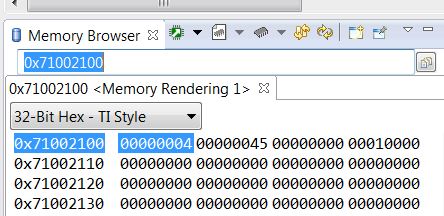

    I apologize for the late response! I debugged the M4 PCIE issue when loaded from Linux side. My setup is two TI AM572x IDK EVMs, on side runs as PCIE EP, the other side runs as PCIE RC. I knew when M4 PCIE runs standalone the enumeration and mapping worked as the baseline.
    When RC side runs A15 Linux (with the DTB file disabled PCIE) and load the M4 image as you provided in project, I got following from M4 side:
    1) Link is up
    2) RC side OB region 1:
    So this region is for data access with base + 0x0500_0000 to 0x05FF_FFFF

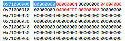

    3) Then I modified RC side to OB region 0
    This region is for configuration access, with base + 0x0400_4000 to 0x0404_4FFF
    With physical PCIE SS1 space unmapped (0x2000_0000 to 0x2000_0000), this is bitband region, I was not able to access 0x2400_4000 for configuration access (nothing from CCS memoey window, all ????????)

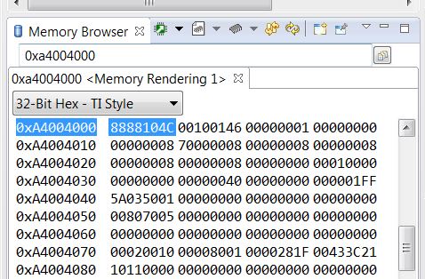

    Then, I modified:
    #define PCIE_SS1_CFG_SPACE 0x20000000
    #define PCIE_SS1_CFG_SPACE_VIRT 0xA0000000 (this is a unused region)
    and looked at below:
    0x8888104C is the remote TI PCIE device.

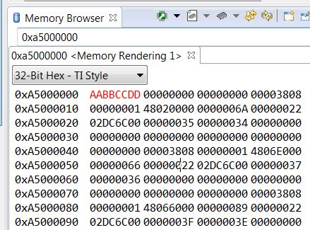

    For the data access, say I wrote 0xa500_0000 with a pattern:
    Then at EP side,

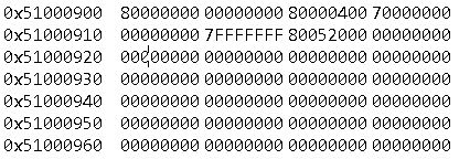

    I changed 0x5100_0900 =  0x8000_0000 to inbound region 0,
    Then I new I should look for 0x8005200 for data landed:
    Yes, they are there.
    So the real issue is M4 side physical to virtual address mapping. Hope this helps and give you some debug tips on your side.

  • Thanks Eric,
    This seems to work for me now.
    I did try re-mapping the PCIe before but I most likely used a memory region that was already reserved.
    Now, I can see the remote endpoint device and vendor ID.
    Cheers,
    - David
