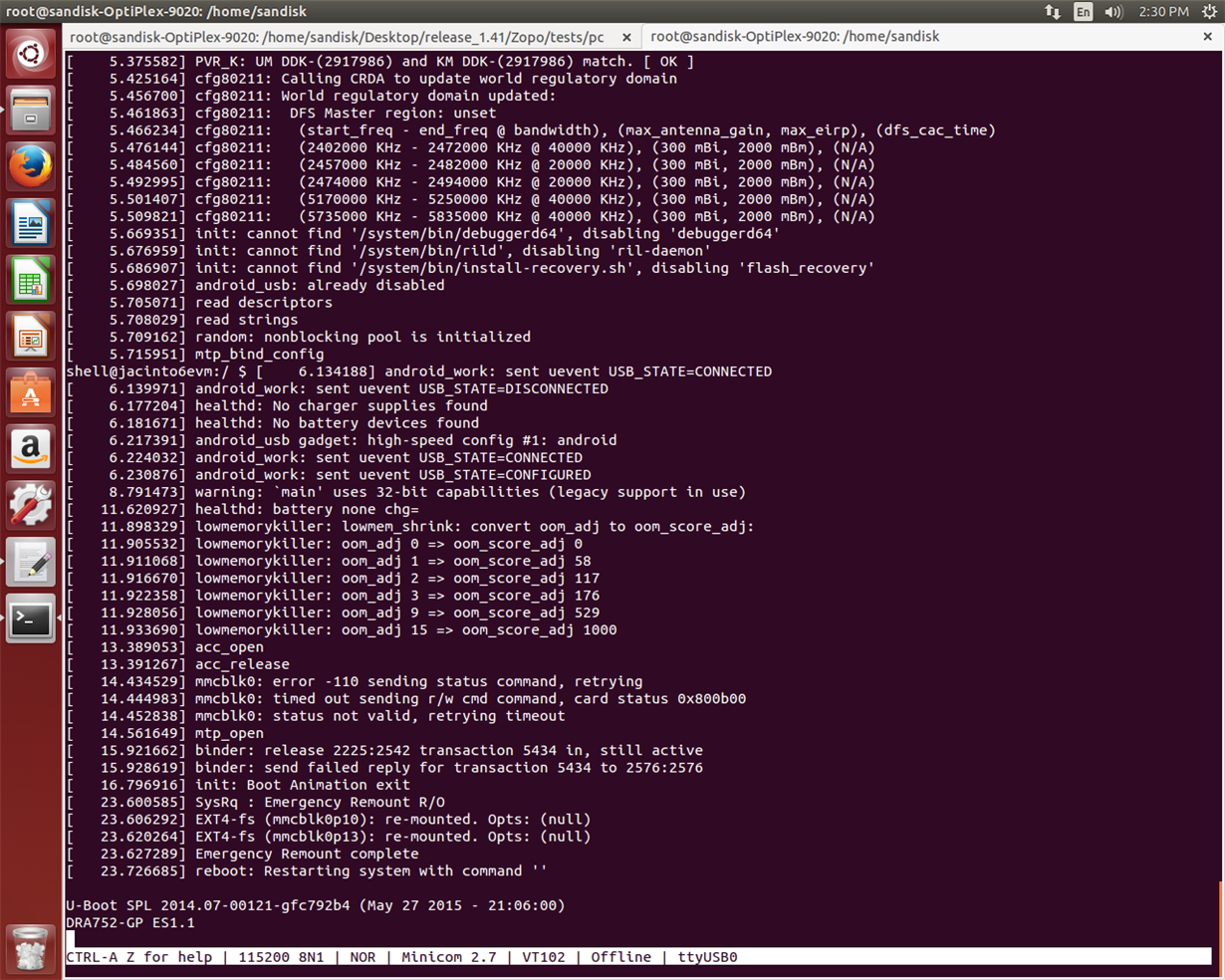

 While I am running long time automation test for reboot gets  cpu hang and failed to reboot in "VAYU EVM XC5777X CPU Boards (Jacinto 6)".
When the cpu hang its failed to do 'Soft_reset' and not able to reboot, but when i press 'cpu_reset' button from the board manually, it continuous to work.

    Ok, its TI-EVM. What is revision of board. You can provide u-boot console log.
    There was a warm reset issue on silicon revision 1.0/1.1, that's why reboot was not working. It should work latest Rev-H EVM SR2.0 revision.

    U-boot log at hang time as follows,
    [ 11.620927] healthd: battery none chg=
    [ 11.898329] lowmemorykiller: lowmem_shrink: convert oom_adj to oom_score_adj:
    [ 11.905532] lowmemorykiller: oom_adj 0 => oom_score_adj 0
    [ 11.911068] lowmemorykiller: oom_adj 1 => oom_score_adj 58
    [ 11.916670] lowmemorykiller: oom_adj 2 => oom_score_adj 117
    [ 11.922358] lowmemorykiller: oom_adj 3 => oom_score_adj 176
    [ 11.928056] lowmemorykiller: oom_adj 9 => oom_score_adj 529
    [ 11.933690] lowmemorykiller: oom_adj 15 => oom_score_adj 1000
    [ 13.389053] acc_open
    [ 13.391267] acc_release
    [ 14.434529] mmcblk0: error -110 sending status command, retrying
    [ 14.444983] mmcblk0: timed out sending r/w cmd command, card status 0x800b00
    [ 14.452838] mmcblk0: status not valid, retrying timeout
    [ 14.561649] mtp_open
    [ 15.921662] binder: release 2225:2542 transaction 5434 in, still active
    [ 15.928619] binder: send failed reply for transaction 5434 to 2576:2576
    [ 16.796916] init: Boot Animation exit
    [ 23.600585] SysRq : Emergency Remount R/O
    [ 23.606292] EXT4-fs (mmcblk0p10): re-mounted. Opts: (null)
    [ 23.620264] EXT4-fs (mmcblk0p13): re-mounted. Opts: (null)
    [ 23.627289] Emergency Remount complete
    [ 23.726685] reboot: Restarting system with command ''
    U-Boot SPL 2014.07-00121-gfc792b4 (May 27 2015 - 21:06:00)
    DRA752-GP ES1.1
    u-boot Hangs at this position and device is not booting after this,
    When i press hard cpu reset key then it proceed rebooting.

    As explained in earlier mail thread, its a known issue on ES1.1 silicon.
    This issue has been fixed in Silicon revision 2.0.
    Ravi
  • Hi Ravi,
    You are talking about erratum i875 Power-on-Reset (PORz) Warm Boot Hang. Am I right?
    If true, I'm wondering if Vincie can implement the workaround as described in erratum? I'm attaching it below.
    Stan
    A board level workaround requires adding a 220 Ohm (+/- 5%) resistor onto the SRAM
    LDO supply (Cap_vddram_mpu1, ball K16 on the SoC package with ABC designator
    (that is, the 23 mm package)). This resistor provides a controlled discharge path for the
    charge contained within the external 1μF LDO capacitor during the reset operation. The
    workaround effectiveness assumes that the active duration of the PORz signal is a
    typical 3.4 ms or greater.
    In systems with an MCU present, a second workaround technique can be utilized. The
    MCU performs a handshake with the device following a warm PORz to ensure that the
    device is responsive after the reset. On the occasion a hang occurs, the MCU should
    assert PORz low for 200 ms. This eliminates the need for an external 220 Ohm resistor.
